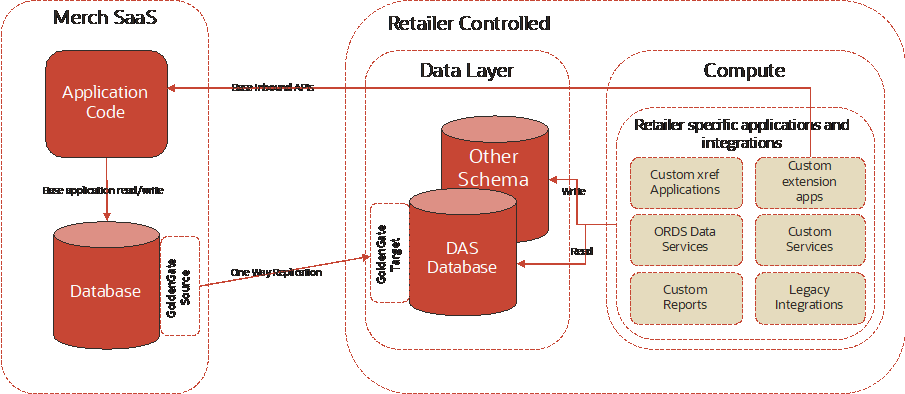

For more information on using the RDS see the Retail Data Store Implementation Guide.The DAS is a one-way, near real-time replication of data. The target environment would live in an on-premise or PaaS environment, which could also be used to host the custom application.
If you use this as part of your implementation, you can use the data in the read-only replicated data in the target environment to create your own query web services or as the basis for your custom application. The diagram below shows an example of how this might look.
For more information on using DAS for custom integration and reporting,
see the DAS Developer's Guide on My Oracle Support note 2082126.1.
The following image depicts how a custom extension or report would be created using the DAS. A similar view for the RDS can be found in the “Implementation Overview” section of the Retail Data Store Implementation Guide.
