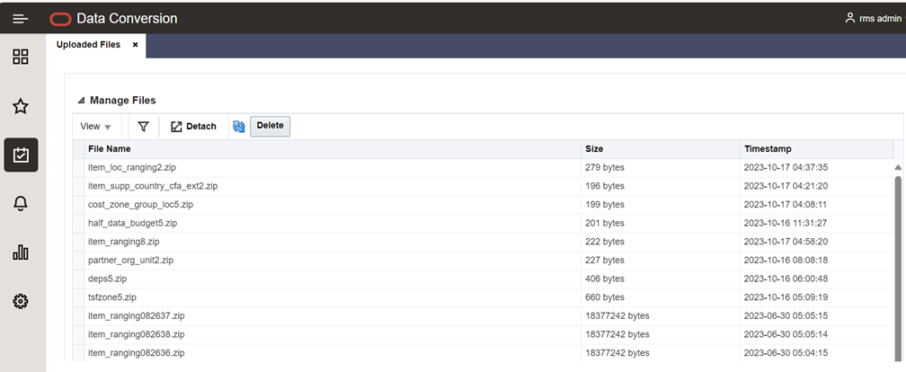

The Uploaded Files screen in the Data Conversion Application displays the files you have uploaded and, as necessary, the screen allows you to delete unwanted files. To access this screen, select Uploaded Files from the task list.
When you click on the refresh icon button (
), all the input files that are not yet imported into the data conversion schema are
displayed on the screen. You can delete one or more of these unprocessed files by first
selecting the file(s) and then clicking the Delete option on the
toolbar. The delete operation must be performed by an administrator user and should be
carefully invoked such that it does not overlap with a data migration run. Once the delete is
triggered, it runs as a synchronous process. After a file is removed, it is no longer be
displayed on this screen or available for import in the data conversion schema.
