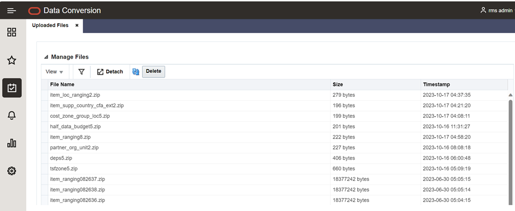

The Uploaded Files screen in the Data Conversion Application displays the files you have uploaded and, as necessary, the screen allows you to delete unwanted files. To access this screen, select Uploaded Files from the task list.
When you click on the refresh icon button (Refresh icon), all the input files that are not yet imported into the data conversion schema are displayed on the screen. You can delete one or more of these unprocessed files by first selecting the file(s) and then clicking the Delete option on the toolbar. The delete operation must be performed by an administrator user and should be carefully invoked such that it does not overlap with a data migration run. Once the delete is triggered, it runs as a synchronous process. After a file is removed, it is no longer be displayed on this screen or available for import in the data conversion schema.
Uploaded Files Screen
