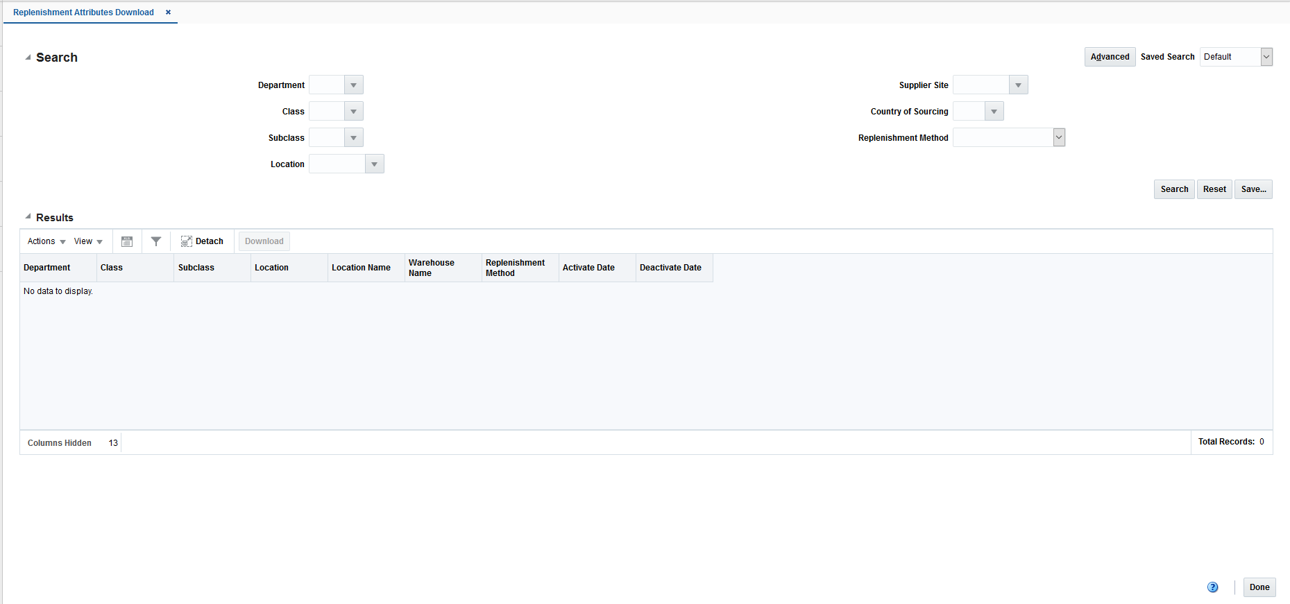

The snapshot below shows the basic version of the screen that is used for the download process.
Figure 5-1 Replenishment Attributes Download Page

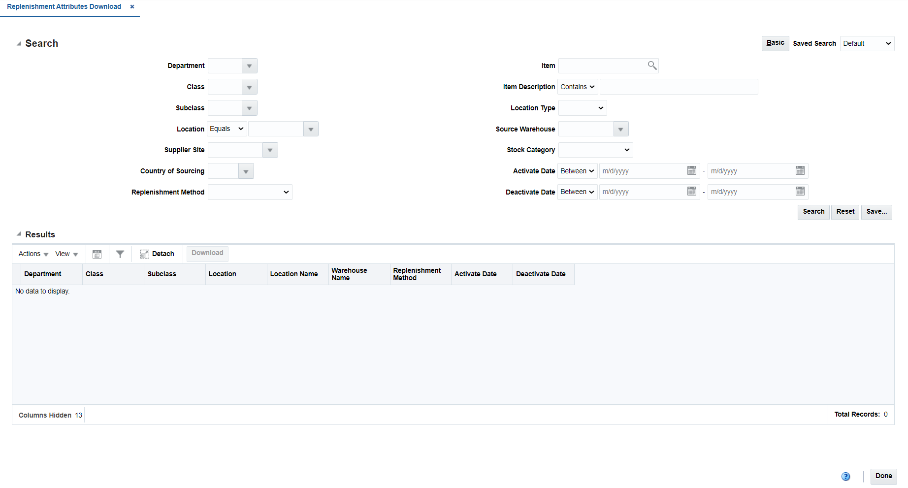

The advanced version has a few additional operators such as the Location, Activate / Deactivate Date and Item Description for refinement of search results.
Figure 5-2 Replenishment Attributes Download Advanced Search Page

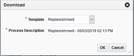

Once you have the required data queried into the search results, click the Download button to initiate the export. A pop-up will be displayed to allow you to select the template into which the data will be extracted. The Process Description field will default to a value based on the current timestamp, but it can be manually updated for tracking the download process in case of any issues.
Figure 5-3 Attribute Download Pop-up

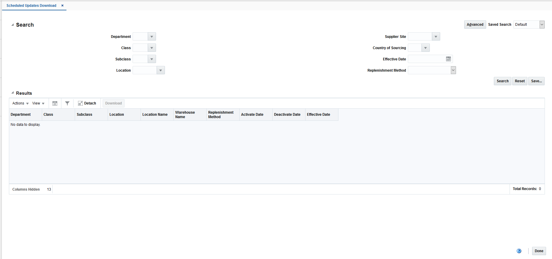

The snapshot below shows the screen that is used for the download process.
Figure 5-4 Scheduled Updates Download Page
Once you have the required data queried into the search results, click on the Download button to initiate the export. A pop-up will be displayed to allow you to select the template into which the data will be extracted. The Process Description field will default to a value based on the current timestamp, but it can be manually updated for tracking the download process in case of any issues.
Figure 5-5 Attribute Download Pop-up

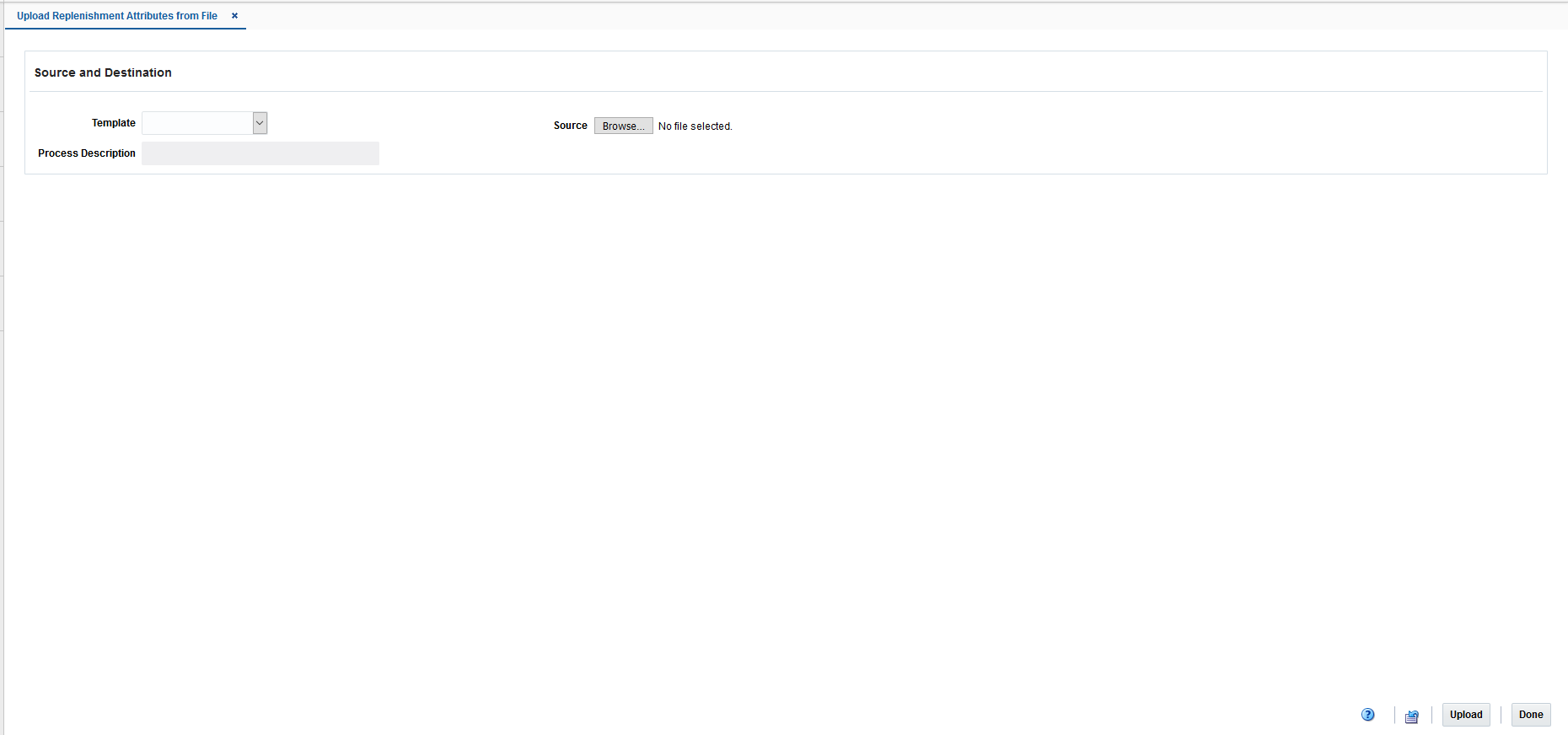

Once the data has been updated into the spreadsheet, the next step will be to upload this into Merchandising. This can be done by selecting the Upload Replenishment Attributes option under Replenishment in the Merchandising task list. To do this, you will have to select the template that you used for creating the spreadsheet and then select the location where your file has been saved. Finally, a process name is defaulted to allow tracking of the progress of the upload based on the activity timestamp after it is submitted; but this can be edited, if required.
The snapshot below shows the screen that is used for the upload process.
Figure 5-6 Upload Replenishment Attributes Page
Upon clicking the Upload button, the information will be processed by Merchandising in the background. If there are any errors, a notification will be sent to you to review the issues and correct the data. In case of no errors, no notification will be sent, but the status can still be validated by accessing the Data Loading > Review Status option in the task list.
