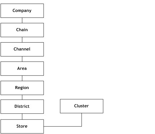

The following is an example of an application-modified dimension. Here is an example of a location hierarchy that is configured in an application.
Figure G-1 Hierarchy with Levels That Correspond to CDTs
Description of "Figure G-1 Hierarchy with Levels That Correspond to CDTs"
Within a specific workbook, the relationship between store and cluster will vary based on the class in the workbook. The dimension information in the application is basically a placeholder and is replaced with the contents of the mapping measures. If the workbook contains more than a single class, then RPASCE will only use the mapping for the first class.
