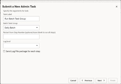

Select the Daily Batch that corresponds to the batch_daily task that has been modified, as shown in the following figure.
Figure 19-16 Select Daily Batch

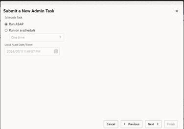

Schedule the daily batch to run at specific time or run ASAP, as shown in the following figure.
Figure 19-17 Schedule Daily Batch

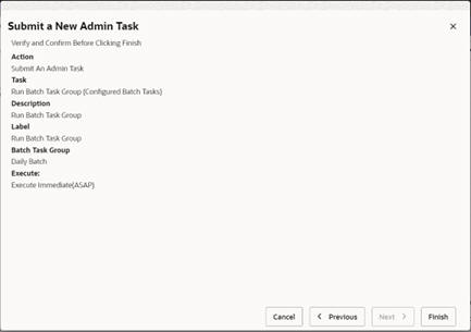

Verify and confirm the options you have chosen.
Figure 19-18 Verify and Confirm Options Selected
