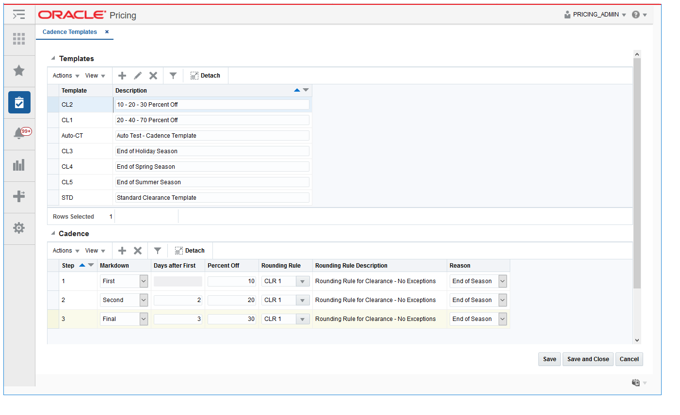

From the Tasks menu, select Clearance Cadence Templates under Foundation Data. The Cadence Templates tab appears.
Figure 3-1 Cadence Templates

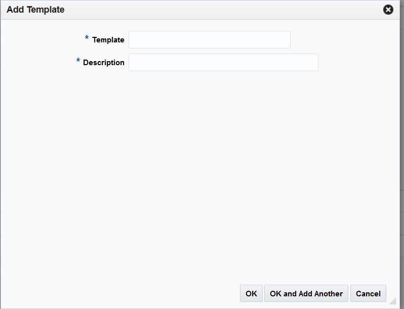

Select Add from the Action menu. The Add Template dialog appears.
Figure 3-2 Add Template Dialog
Enter the template details for the following fields:
Template – This field is used for providing the template ID.
Description – The description of the cadence template.
Additional fields may be displayed based on system option settings.
Click OK to add the new template. You are returned to the Cadence Templates tab.
Click OK and Add Another to add the current template to the table and add another without leaving the Add Template dialog.
From the Template table, highlight the template you want to edit and select Edit from the Actions menu. The Edit Template dialog appears.
From the Edit Template dialog, make any desired changes to the template.
When all edits are complete, click OK. You are returned to the Cadence Templates tab.
