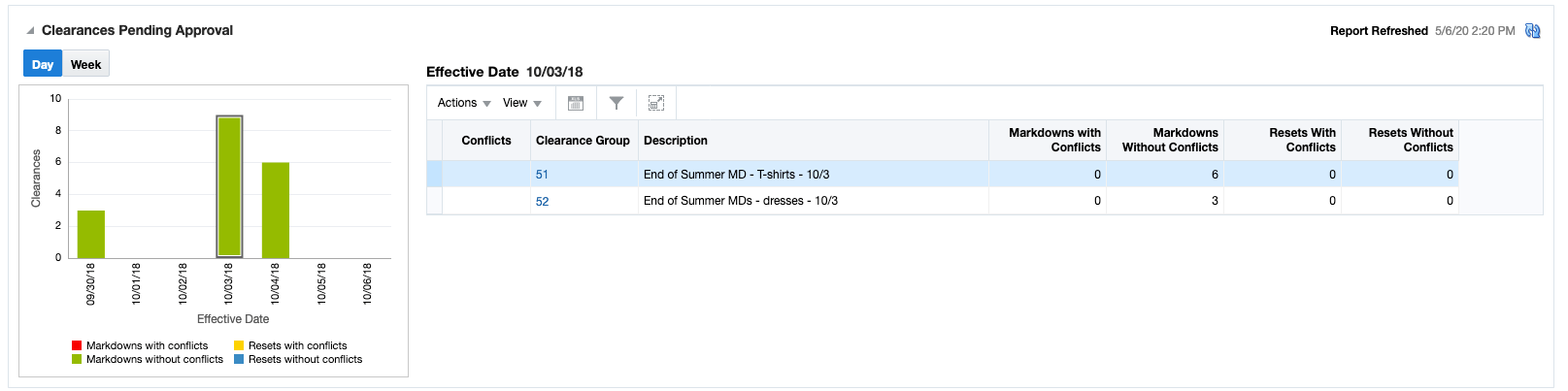

Clearances Pending Approval Report
The Clearances Pending Approval report is intended to provide the pricing analyst with a view to unapproved clearance markdowns or resets that have an effective date in the next week or over the next four weeks, based a report level toggle.
Dashboard Filters
All dashboard-level filters are applicable to this report and the clearance groups shown in the report will be associated with the filter criteria specified.
Report Details
The report consists of a tile shown at the top of the dashboard, a bar chart, and a table.
Tile
The tile for this report shows a count of clearance markdowns and resets that are not yet approved but have an effective date in the next four weeks, based on the dashboard filter criteria. Both worksheet and submitted clearance events are considered. It also displays a bar chart that shows how the markdowns and resetsFoot 1 are distributed over those four weeks. Any weeks that have emergency markdowns or resets will be shown in red.
The color of the tile changes colors to reflect the severity issues represented by unapproved markdowns and resets. The rules for this are defined in the table below.
| Tile Color | Rule |
Green |
There are no emergency markdowns or resets and The total count of markdowns and resets is less than the Critical Count of Unapproved Clearances report option. |
Yellow |
At least one emergency markdown or reset or There are more markdowns and resets needing approval than the Critical Count of Unapproved Clearances report option. |
Red |
At least one emergency markdown or reset and There are more markdowns and resets needing approval than the Critical Count of Unapproved Clearances report option. |
Bar Chart and Table
The stacked bar chart has two views - one which shows the markdowns and resets needing approval, by day, for today and the next 6 days, and one where it shows these events for the next four weeks. In both cases, the charts shows the count of markdowns and resets that have effective dates in a time period, differentiated by whether it is a markdown with conflicts, markdown without conflicts, reset with conflicts, or reset without conflicts. Clicking on a bar in the chart will refresh the data in the table based on the time period selected. The first day or first week is selected by default in the chart.
The table shows a summary of the clearance groups that have markdowns or resets in the selected time period from the bar chart. The details available in the table for each group include:
| Tile Color | Rule |
Conflict |
Displays a conflict icon ( |
Clearance Group |
Indicates the group that contains the markdowns and resets that require approval. This ID is a hyperlink that will take the pricing analyst to the Clearance Group page to view the details of the markdowns and resets and act to approve them or update dates. |
Description |
The description of the group. |
Markdowns with Conflicts |
The count of markdowns in the group that are not approved and have conflicts. |
Markdowns without Conflicts |
The count of markdowns in the group that are not approved, but don't have conflicts. |
Resets with Conflicts |
The count of resets in the group that are not approved and have conflicts. |
Resets without Conflicts |
The count of resets in the group that are not approved, but don't have conflicts. |
Earliest Effective Date |
The earliest effective date for a markdown or reset in the group that requires approval. |
Report Actions
Edit Clearance Group - Selecting this option from the Actions menu, or clicking on the clearance group hyperlink, will take the pricing analyst to the Clearance Group page where they can approve or update the markdowns and resets, based on privileges.
Review Conflicts - Selecting this option from the Actions menu, or clicking on the conflict icon in the table, will take the pricing analyst to the Conflicts screen for more details on the conflicts contained in the clearance group.

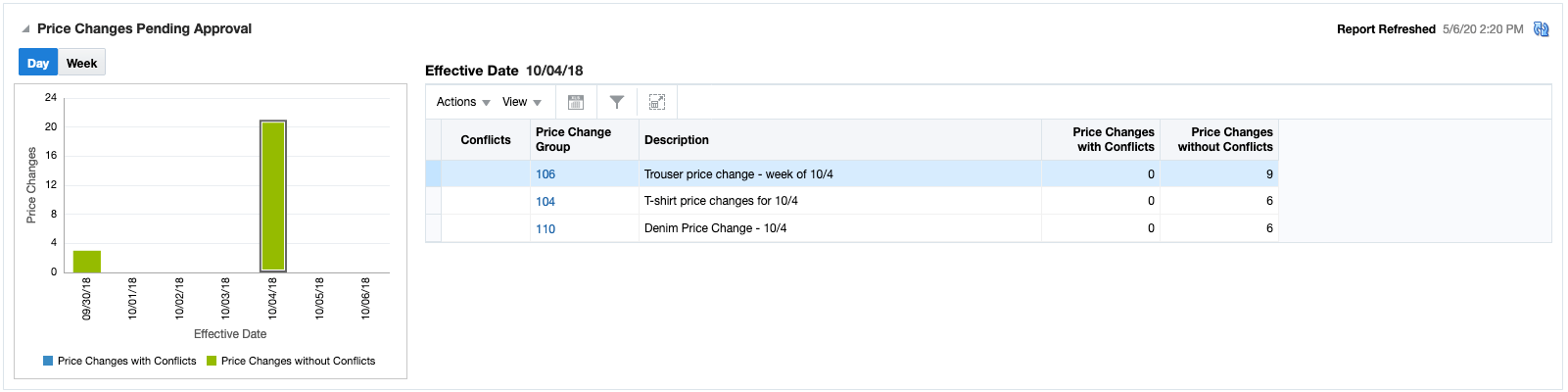

Price Changes Pending Approval Report
The Price Changes Pending Approval report is intended to provide the pricing analyst with a view to unapproved price changes that have an effective date in the next week or over the next four weeks, based a report level toggle.
Dashboard Filters
All dashboard-level filters are applicable to this report and the price change groups shown in the report will be associated with the filter criteria specified.
Report Details
Tile
The tile for this report shows a count of price changes that are not yet approved but have an effective date in the next four weeks, based on the dashboard filter criteria. Both worksheet and submitted events are considered. It also displays a bar chart that shows how the price changes are distributed over those four weeks. Any weeks that have emergency price changesFoot 2 will be shown in red.
The color of the tile changes colors to reflect the severity issues represented by unapproved price changes. The rules for this are defined in the table below.
| Tile Color | Rule |
Green |
There are no emergency price changes and The total count of price changes is less than the Critical Count of Unapproved Price Changes report option. |
Yellow |
At least one emergency price changes or More there are more price changes needing approval than the Critical Count of Unapproved Price Changes report option. |
Red |
At least one emergency price changes and More there are more price changes needing approval than the Critical Count of Unapproved Price Changes report option. |
Bar Chart and Table
The stacked bar chart has two views - one which shows the price changes needing approval, by day, for today and the next 6 days, and one where it shows these events for the next four weeks. In both cases, the charts shows the count of price changes that have effective dates in the time period, differentiated by whether it is a price changes with conflicts or a price changes without conflicts. Clicking on a bar in the chart will refresh the data in the table based on the time period selected. The first day or first week is selected by default in the chart.
The table shows a summary of the price change groups that have price changes in the selected time period from the bar chart. The details available in the table for each group include:
| Tile Color | Rule |
Conflict |
Price Change Group |
Indicates the group that contains the price changes that require approval. This ID is a hyperlink that will take the pricing analyst to the Price Change Group page to view the details of the price changes and act to approve them or update dates. |
Description |
Price Changes with Conflicts |
The count of price changes in the group that are not approved and have conflicts. |
Price Changes without Conflicts |
The count of price changes in the group that are not approved, but don't have conflicts. |
The earliest effective date for a price change in the group that requires approval. |
Report Actions
Edit Price Change - Selecting this option from the Actions menu, or clicking on the price change group hyperlink, will take the pricing analyst to the Price Change Group page where they can approve or update the price changes, based on privileges.
Review Conflicts - Selecting this option from the Actions menu, or clicking on the conflict icon in the table, will take the pricing analyst to the Conflicts screen for more details on the conflicts contained in the price change group.

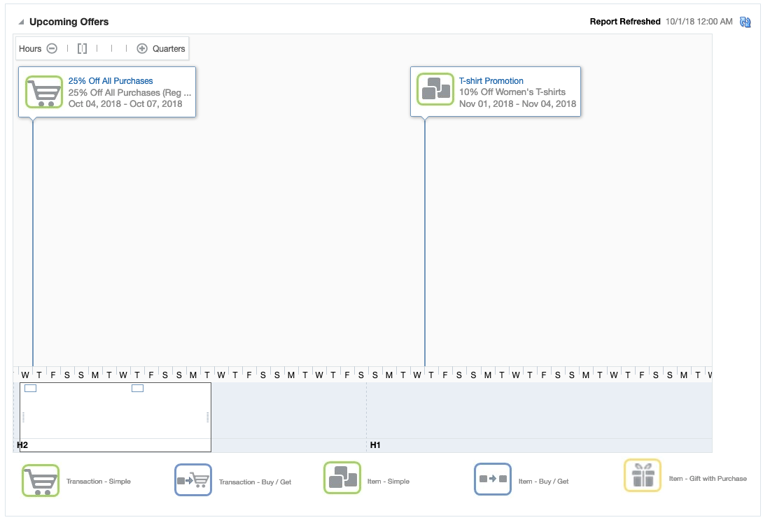

Promotion Planner
This dashboard displays to a promotion planner details about upcoming promotional offers for their area of responsibility, as determined by the dashboard filters.
Upcoming Offers Report
The Upcoming Offers report is a timeline view of promotional offers that will occur in the next 6 months, based on the entered filter criteria. It is intended to help the promotional planner visually see where there may be too many or too few offers in effect for a given period.
Dashboard Filters
All dashboard-level filters are applicable to this report and the promotional offers shown in the report will be associated with the filter criteria specified.
Report Details
The report consists of a tile shown at the top of the dashboard and a timeline.
Tile
The tile for this report shows a count of promotional offers that are scheduled to start in the next six months. It also displays a bar chart that shows how the offers are distributed over those six months.
Timeline
The timeline portion of the report shows the offers spread out over a timeline that covers the next 6 months. A zoom feature on the report allows the promotional planner to zoom in to see offers by a granular of a time period as by hour, or zoom out as far as by quarter. The default view will be by day.
For each offer included in the timeline, the name of the promotion and the offer will be displayed, as well as the start and end dates for the offer. The promotion name will be a hyperlink that allows the promotional planner to launch into the promotion to view or edit the details of the offers. Additionally, an icon will show the type offer: Transaction - Simple, Transaction - Buy/Get, Item - Simple, Item - Buy/Get, or Item - Gift with Purchase.
A promotional planner can navigate along the timeline by using the slider at the bottom of the chart, or the arrows on the sides of the chart to navigate. The slider section indicates what is currently being viewed and will also show a very zoomed out view of the offers over the full 6-month period.
