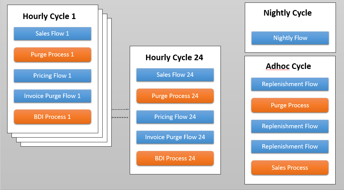

Batch Schedule
POM logically groups batch jobs in a batch schedule into a hierarchy of Processes, Flows and Cycles based on functionality and expected execution frequency.
Figure 2-1 Batch Schedule Diagram

A Batch Cycle is the container in which Flows, Processes and Jobs are setup. There are three types of Batch Cycles.
Adhoc / Standalone Cycle
The Flows and Processes defined in this Cycle can run multiple times a day on an as-needed basis. Such invocations can run independent of other Processes and Flows on other Cycles.
Example: A Flow can be defined whose main responsibility is to purge data in database tables to boost performance. This Flow can then be run every 15 minutes without impacting Flows or Processes on other Cycles.
Recurring / Hourly Cycles
Recurring or Hourly Cycles are specialized Batch Cycles with the following properties
A Batch Schedule can have a maximum of 24 Hourly Cycles.
The Flows and Processes defined on an Hourly Cycle are replicated across all the defined Hourly Cycles. Dependencies are built between these batch entities, to ensure that unless it is completed in a prior cycle, it will not run in the next cycle.
All the Hourly Cycles are meant to be run prior to running the Nightly Flow. Once the Nightly Flow starts, all the Jobs on the Hourly Cycles are marked completed.
Example: The Sales processing Jobs in RMS support trickle processing by running every 30 minutes during the store trading hours. The schedule is pre-loaded with 24 Hourly Cycles. The Hourly Cycles are time triggered from the Scheduler or through ReST APIs externally. Based on the client's business operations, the individual flows of each cycle need to be scheduled.
If there are any errors on the Hourly Cycles, then the Nightly Cycle will not start until they are resolved.
Nightly Cycle
This Batch Cycle contains the set of Jobs that are executed at end of the business day. All of these Processes and Jobs belong to the default Nightly Flow of this Cycle. Once the Nightly Flow has started, all the loaded Flows and Processes on the Hourly Cycles are marked complete.
The Nightly Flow can be time-triggered or triggered using Schedule Links. It can be time-triggered through the POM Scheduler or externally through the ReST API.
