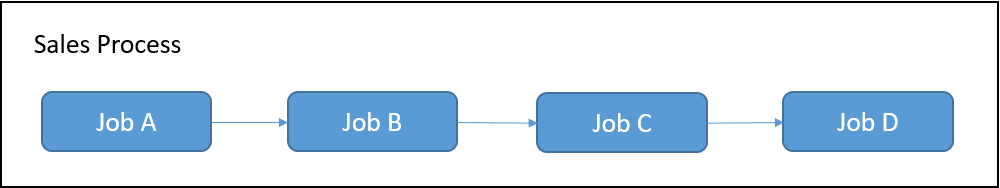

Batch Process
A Batch Process is a collection of related Batch Jobs that will always run in sequential order. The dependencies between the Jobs within a Process ensure that these Jobs cannot be run in parallel.
Batch Processes on the Adhoc Cycle can be run from the POM UI or invoked using the ReST API. See Invoking the POM Service in the Integration chapter of this guide.

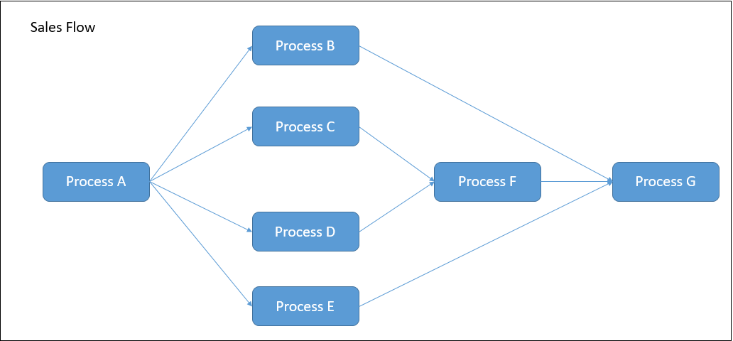

Batch Flow
A Batch Flow is a collection of related Batch Processes that must be run as a single unit. Within a Batch Flow one Process must be designated as the "first" Process, and another as the "last" Process. Other Processes can be run between them in sequential or parallel fashion, based on the dependencies setup.
Batch Flows can be defined on the Hourly Cycles and the Adhoc Cycle. The Flows on the Hourly Cycle can only be run once, while the Flows on the Adhoc Cycle can be run any number of times. These Flows can be invoked from the POM UI and can also be invoked through the ReST API. See Invoking the POM Service in the Integration chapter of this guide.

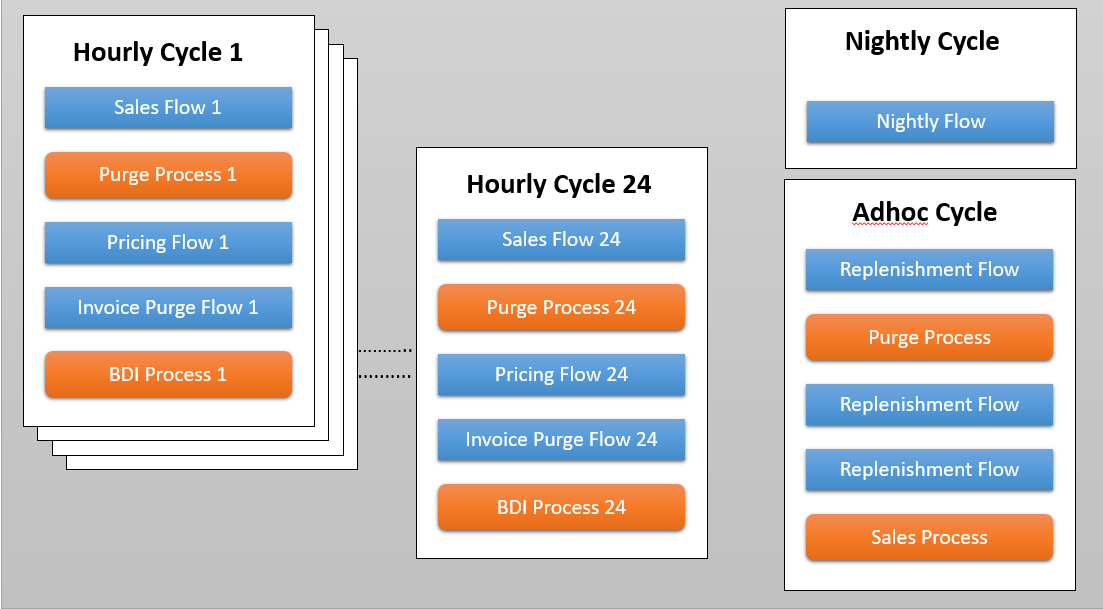

Batch Cycle
A Batch Cycle is the container in which Flows, Processes and Jobs are setup. There are three types of Batch Cycles.
Adhoc / Standalone Cycle
The Flows and Processes defined in this Cycle can run multiple times a day on an as-needed basis. Such invocations can run independent of other Processes and Flows on other Cycles.
Example: A Flow can be defined whose main responsibility is to purge data in database tables to boost performance. This Flow can then be run every 15 minutes without impacting Flows or Processes on other Cycles.
Recurring / Hourly Cycles
Recurring or Hourly Cycles are specialized Batch Cycles with the following properties
                              A Batch Schedule can have a maximum of 24 Hourly Cycles.
                              The Flows and Processes defined on an Hourly Cycle are replicated across all the defined Hourly Cycles. Dependencies are built between these batch entities, to ensure that unless it is completed in a prior cycle, it will not run in the next cycle.
                              All the Hourly Cycles are meant to be run prior to running the Nightly Flow. Once the Nightly Flow starts, all the Jobs on the Hourly Cycles are marked completed.
Example: The Sales processing Jobs in RMS support trickle processing by running every 30 minutes during the store trading hours. The schedule is pre-loaded with 24 Hourly Cycles. The Hourly Cycles are time triggered from the Scheduler or through ReST APIs externally. Based on the client's business operations, the individual flows of each cycle need to be scheduled.
If there are any errors on the Hourly Cycles, then the Nightly Cycle will not start until they are resolved.
Nightly Cycle
This Batch Cycle contains the set of Jobs that are executed at end of the business day. All of these Processes and Jobs belong to the default Nightly Flow of this Cycle. Once the Nightly Flow has started, all the loaded Flows and Processes on the Hourly Cycles are marked complete.
The Nightly Flow can be time-triggered or triggered using Schedule Links. It can be time-triggered through the POM Scheduler or externally through the ReST API.
