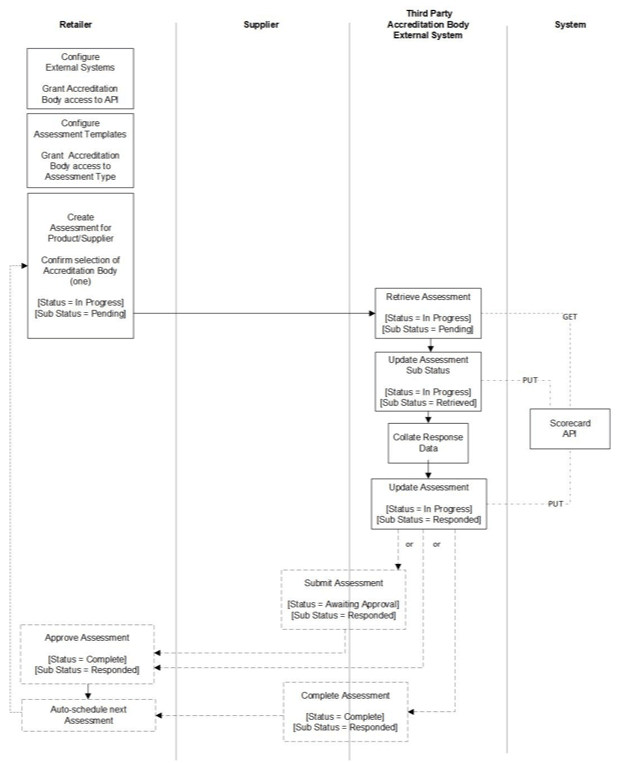

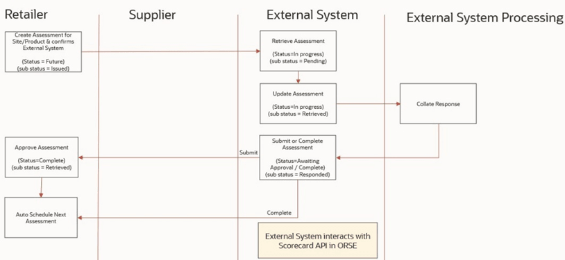

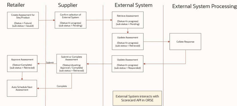

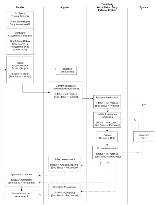

The process for third parties to retrieve, respond to, and return Assessments they have been assigned is shown in the following diagrams. The key difference between the two models is: for Supplier Owned, the supplier is notified of the new Assessment and returns the populated Assessment to the retailer, whereas for Retailer Owned, the Assessment is created by the retailer and is assigned directly to the third party, who returns the populated Assessment to the retailer.
Supplier Owned Integration Type
This image shows the supplier-owned integration type.
Retailer Owned Integration Type
This image shows the retailer-owned integration type.

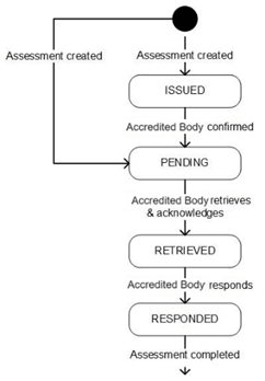

Sub Status
A Sub Status field on the Assessment is used to control the workflow of those being progressed with a third party:
This image shows the sub status.
Third parties retrieve Assessments that have been assigned to them and submit an update to set the sub status to indicate they have been retrieved. Once the questions have been populated with responses that represent the data being provided, a further update is submitted, setting the sub status to indicate they have responded.
For this use case, the retailer requests individual suppliers to progress an Assessment which contains questions for which responses requires third party data. The retailer typically creates the Assessment for the supplier to take responsibility for its completion; alternatively, the supplier may create the Assessment themselves. An Assessment may contain a combination of questions requiring responses to be sourced from the third party and also responses from the supplier. The supplier then submits the Assessment to the retailer if approval is required, otherwise completes it themselves.
For this use case, the retailer requests a third party to provide data for a product or range of products. The retailer creates the Assessment, which is associated to a supplier (so the supplier will also have access to the Assessment). The third party submits the Assessment to the retailer if approval is required, else completes it themselves.

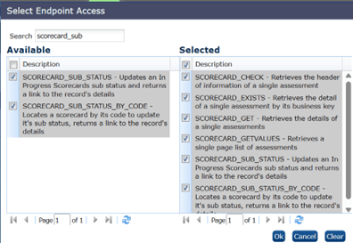

Enabling Sub Status Endpoints
To enable the endpoints for updating an Assessment’s sub status, add the following Endpoint Access records to the Scorecard Service Access record in the Roles & Permissions section of the Admin area:
Code: SCORECARD
Description: Scorecard RESTful Service
Endpoint Access: SCORECARD_SUB_STATUS and SCORECARD_SUB_STATUS_BY_CODE
This image shows the Select Endpoint Access.
