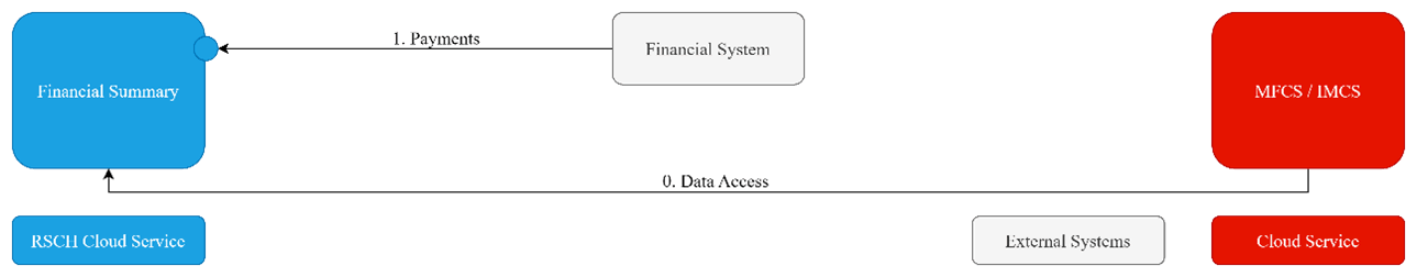

Financial Summary gives the possibility to share with suppliers visibility of their payment's status.
Integration High Level
Figure 23-1 Financial Summary Integration High Level

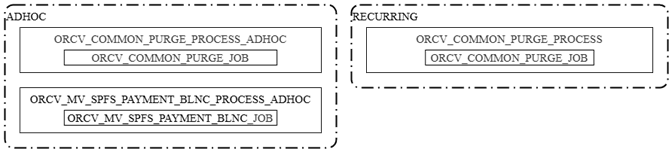

Batch scheduler details with all batches, dependencies and frequencies can be downloaded following the steps in the Supply Chain Hub Frameworks section.
Schedule Overview
Figure 23-2 Financial Summary Batch Schedule Overview

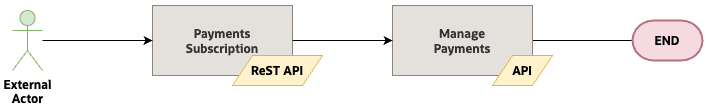

Integration by Module
Figure 23-3 Financial Summary Integration by Module
STEP DESCRIPTION
0 RSCH Data Access of MFCS data
1 Integration of Payments from External Financial System with to Financial Summary via Rest Service.
