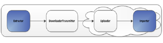

Figure N-1 BDI Process Flow Process
The BDI process:
  • An Extractor extracts data from a data producing system into an outgoing intermediate integration interface table.
  • A Downloader and transporter services data to receiver service.
  • An Uploader uploads the data to an incoming intermediate integration interface tables.
  • An Importer imports the data from the interface stage tables into SIOCS application tables.
For more information about data seeding, see Data Seeding.
With this approach, the BDI Ext Process Flow will move the data from sourcing system to destination system's application table. BDI process flow provides BDI job scheduling, end to end data transportation from sourcing system's database table into destination application's tables.
Customer need to implement the BDI Ext-EdgeApp to move data into the BDI outbound interface table.
BDI Process Flow: ExtRfid_Tx_ProcessFlow_From_EXTERNAL
See Oracle Retail Enterprise Integration Overview Guide: BDI Third-Party Integrations.

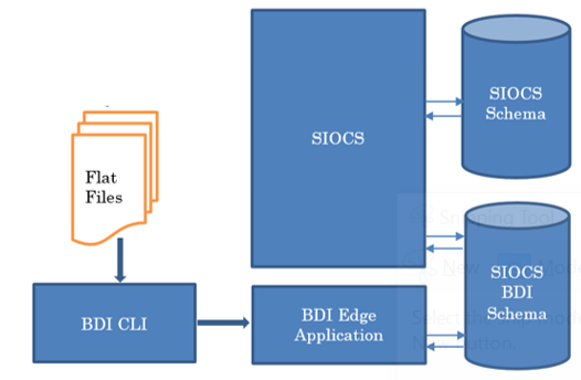

Option B: Third-Party RFID Integration Via BDI CLI File Transmitter
BDI CLI File Transmitter is a client command line tool, is applicable for smaller data file size which does not require concurrent processing.
BDI CLI file transmitter only transport data files from sourcing systems to destination system's interface tables. It does not provide end to end data transportation. If you choose BDI CLI File transmitter for load third-party data into SIOCS application table, it would require three steps:
Figure N-2 BDI CLI File Transmitter
  • Download BDI CLI File Transmitter and install on customer's system.
  • Run BDI CLI Transmitter batch to load data file from sourcing system into destination system's interface table.
  • Once the data are loaded into receiver app's inbound interface tables, EICS's importer job will move the data from inbound interface table into EICS app tables.
By default, batch scheduler Third-Party RFID Import in EICS is disabled; this job should only be enabled if you choose to use BDI CLI File transmitter for data sourcing provider.
See Integration.
This section provides BDI CLI File Transmitter as an implementation to describe how to import third-party RFID into SIOCS via BDI CLI File Transmitter.
