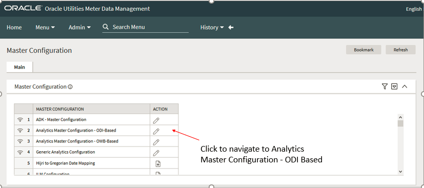

To set the value for this parameter:
- Navigate to the Master Configuration page from the Analytics-Oriented Master configuration portal.
- Navigate to the Oracle Data Integrator-Based master configuration option in the table and click the Edit button under the Action column. This will open the Oracle Data Integrator-Based master configuration page where the values for the parameters can be set.
