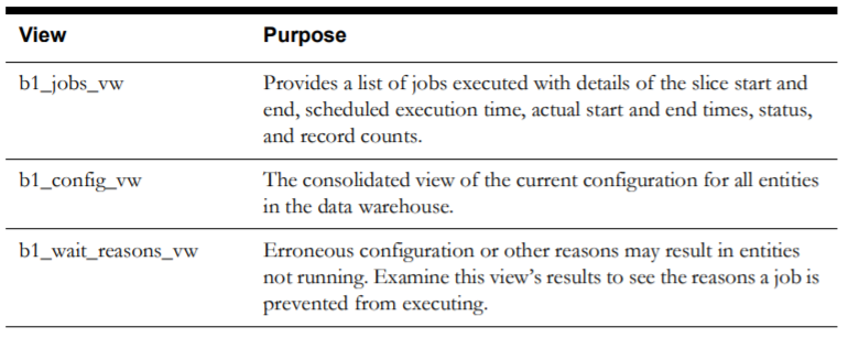

Monitoring the Jobs
As jobs keep running on a regular basis, they are monitored or tracked to ensure that the required performance parameters are met. Jobs are created so that they are capable of automatic re-execution and retries. However, the reasons for the failures should be examined and appropriate actions taken to resolve the issues. The following views are provided for achieving this:

If the issue is related to a table space not being available or database connectivity issues, the jobs would automatically execute once the issue has been resolved. If the issue resolution is anticipated to take a few hours, it is advisable to disable the failing jobs for the duration of the fix.
Query the view B1_JOBS_VW in the metadata schema to identify if any jobs have failed. In case of a failure, the status_flg column will show 'E'. You can log into Oracle Data Integrator and filter by the session number (available in the jobs view) and look at the error encountered.

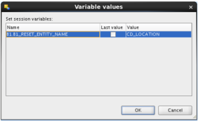

Reset an Entity
Perform the following steps to reset an entity:
  1. Log in to Oracle Data Integrator.
  2. Navigate to the Load Plans and Scenarios section.
  3. Select the scenario named B1_RESET_ENTITY, right-click it, and execute it.
  4. In the dialog box, select the Context. For example, if you wanted to reset the fact for Oracle Utilities Operational Device Management product instance 1, you would select ODM1.
  5. Clear the Last Value checkbox. Specify the variable value and click the Name field.
  6. Click OK. This cleans up the metadata entries to execute the ELT job for this specific entity. The data loaded in the particular table for the entity will also be clear. Note that the ELT job for this entity will be in a “disabled” state.
To start loading data again, enable the ELT job for the entity using the Oracle Utilities Analytics Warehouse Administration Tool.

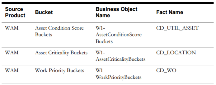

This is the scenario where bucket configurations can be referenced by the fact ELT directly. This is a special use of the bucket configurations where a fact ELT would try to calculate a measure value based on the configured bucket ranges. Few bucket configurations fall under this scenario.
To reload this type of bucket configurations:
  1. Make the necessary changes to the bucket configurations in the source application. For this type of bucket configuration where there is no dedicated bucket dimension, the data is loaded in the metadata table B1_RANGE_LOOKUP in the MDADM schema.
  2. Delete the existing rows in the MDADM.B1_RANGE_LOOKUP table for the specific bucket whose configurations are being updated. The table below identifies the bucket business object name for each source product. The business object name is stored as the range code in the metadata table and can be used to identify the rows to be deleted.
  3. Reload the updated bucket configuration once the identified rows are deleted from the metadata table.

  4. Identify the affected facts for which the bucket configurations are updated (mentioned in the table in step 2). See Configure ETL Parameters and Buckets for details.
  5. Follow the steps mentioned in Reset an Entity above to reload the related facts. This needs to be done because the data that had been loaded into these facts would have been using the older bucket configuration, which gets invalidated when the configuration changes.
