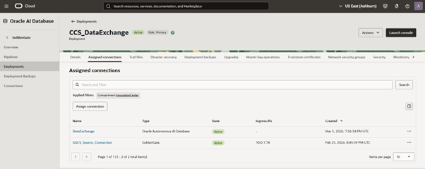

Once you have created these two connections, you must assign them to your GoldenGate deployment:
Figure 19-3 Target Connections
Screen shot showing connections assigned to GoldenGate Deployment
Assigning the connection may attempt to validate it, so at this point correct any connection issues before continuing.
