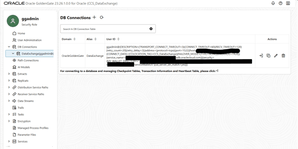

Verify that a DB Connection has been set up to your target database.
Figure 19-8 DB Connections
Screen shot showing DB Connections screen

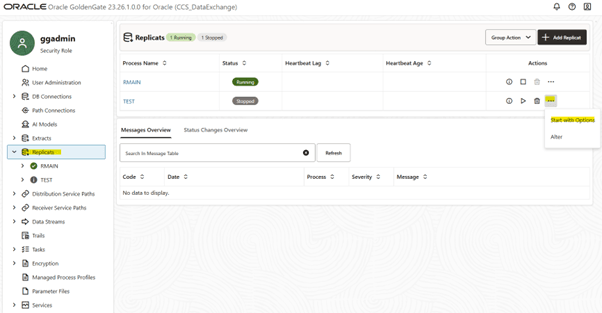

Starting the Replicat(s)
When your Replicat configuration is correct, start the Replicat(s) using the CSN provided by Oracle as follows:
Replicat “…” menu (under Actions) / Start with Options
Figure 19-9 Replicats
Screen shot showing replicat processing
You will receive a CSN from Oracle (a synchronization number, which is taken during the export process), and you should use this as follows:
  • Start Point: After CSN (not At CSN – please be careful of this point)
  • CSN: the provided CSN number (such as 46411763106725)
  • Threads: as required (although as parallelism is defined in the parameter file, you usually set 1 here)
