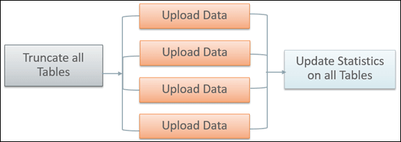

The SQL Loader is running in multiple threads and therefore it is not performing table truncation before loading (command APPEND). Hence, the target tables should be truncated prior to the load. For better performance the indexes have to be disabled before the load and re-enabled/statistics updated after the load. The batch jobs can be organized into various chain structures, as shown in the examples below.
Single Table Upload
Figure 17-1 Single Table Upload
Diagram illustrating upload orchestration for a single table
Multiple Table or Maintenance Object Upload
Figure 17-2 Multiple Table or Maintenance Object Upload
Diagram illustrating upload orchestration for multiple tables or maintenance objects
