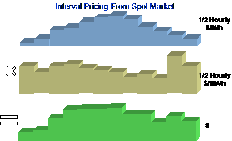

Interval Pricing Rate Application
Interval Pricing is the term used to describe applying interval prices to interval quantities to arrive at a bill calculation line item.
What data is needed in order to apply a rate component for an interval pricing scenario and how is this data defined?
- You need prices that vary at a given interval. Interval prices are stored for a Bill Factor/characteristic. Refer to Bill Factor Interval Values for more information.
- You need consumption values for each corresponding interval. The consumption values are stored for an Interval Profile linked to a service agreement. Refer to Billable Interval Quantities for a Service Agreement for more information. In order to find the correct interval profile for the service agreement, the rate component will reference a Profile Relationship Type. Refer to Physical Attributes of Interval Data vs. Its Role and Interval Data Serves a Role for a Service Agreement for more information.
- You need an algorithm in order to know how to apply the prices correctly. The rate component will reference a Calculation Algorithm, which will be executed to apply the prices to the quantities.
