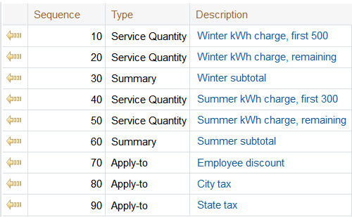

This logic is difficult to explain succinctly, so we'll use an example. Imagine that the Merge From rate components look as follows:
img/c1_bp14rates_rate_version_merge_merge_from.jpg

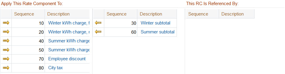

The Rate Component - Cross Reference tab for the merge from rate version shows the following cross-reference information for the State tax rate component:
img/c1_bp14rates_rate_component_cross_ref.jpg

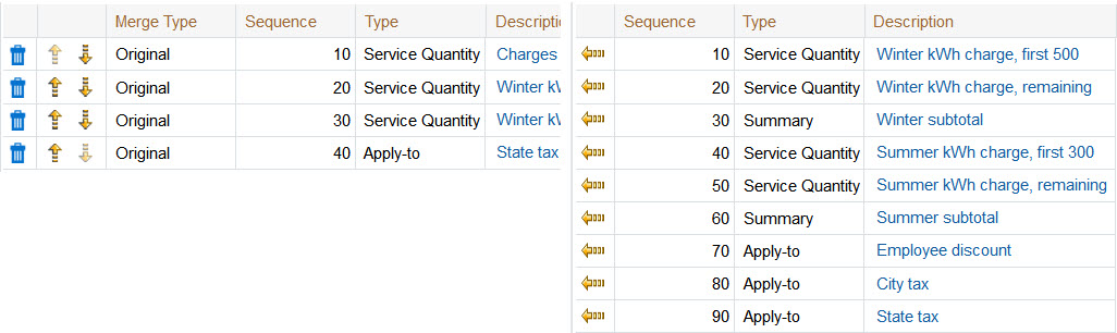

Assume that only the following rate components are copied to the new rate version:
  • Service Quantity (0 to 300 kWh Step)
  • Service Quantity (300 to max)
  • State tax
Also, assume that the original rate version already contains a rate component with a sequence number of one of the merging rate components.
img/c1_bp14rates_rate_version_merge_before_saving.jpg

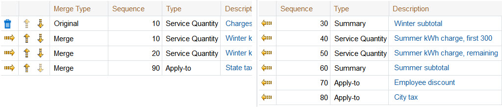

After saving, the second service quantity rate component is renumbered and the State tax rate component will reflect the renumbering in the cross-reference and will not include the rate components that were not copied.
Here is the view on the merge page after saving:
img/c1_bp14rates_rate_version_merge_after_saving.jpg
If you navigate to the Rate Component - Cross Reference tab for the merged rate version for the State tax rate component, it looks as follows:
img/c1_bp14rates_rate_component_new_cross_ref.jpg
If any rate component refers to another rate component in the eligibility criteria, the sequence number of the eligibility criteria is also adjusted accordingly.
