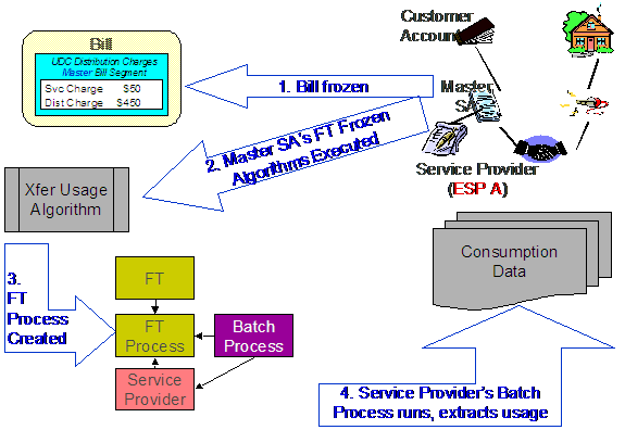

The following illustration shows the logical steps involved with sending consumption to service providers.
In sending consumption to service providers, the application runs the FT Freeze algorithms defined on the SA Types of the service agreements. One of these algorithms determine if there are service providers associated with the master service agreement that needs consumption. If so, the algorithm inserts a row on the FT Process table. Rows on the FT process table triggers batch processes that download billable consumption to the service provider.
The following points explain the steps:
  • When a financial transaction (FT) is frozen, the system executes the FT Freeze algorithms defined on the SA(s) SA type.
  • If you've set up the system properly (i.e., you've put the appropriate FT Freeze algorithm on the master SA's SA type), one of these algorithms will determine if there are service providers associated with the master SA who need consumption. If so, it will insert a row on the FT Process table.
