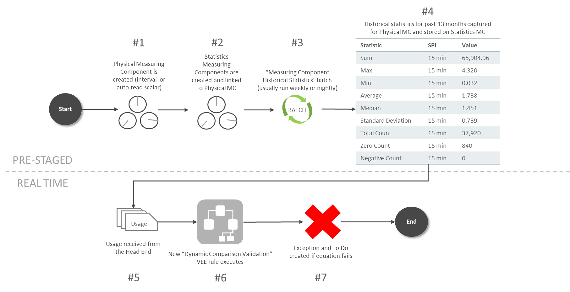

Below is an overview example of how Measuring Component Statistics can be implemented along with the Dynamic Comparison Validation:
The steps for pre-staging Measuring Component Statistics are detailed below:
- A Physical Measuring Component is created. The algorithm to trigger the creation of Statistics Measuring Components is only set on Interval or Auto-Read Scalar BOs as part of base product.
- New Statistics Measuring Component are created and linked to the Physical Measuring Component.
- The Measuring Component Historical Statistics Batch (D1-MCHS) is run based on the schedule you've defined. The suggestion is to run this either nightly or on the weekends during quieter times for overall system processing.
- A measurement is created for the Statistics Measuring Component that holds historical statistics related to the Physical Meter for a specific period of time (in this example it's set for 13 months).
The steps for how VEE can take advantage of Measuring Component Statistics are detailed below:
- IMDs are received from the Head End.
- The Dynamic Comparison Validation VEE Rule is configured to execute for the meter. This validation uses the historical statistics from the Statistics Measuring Component in order to perform its validation logic.
- An exception and potentially a To Do is generated based on the failure of the VEE rule.
