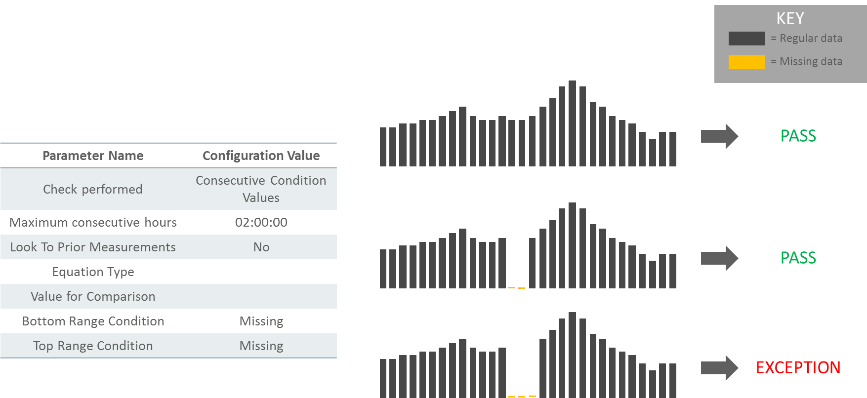

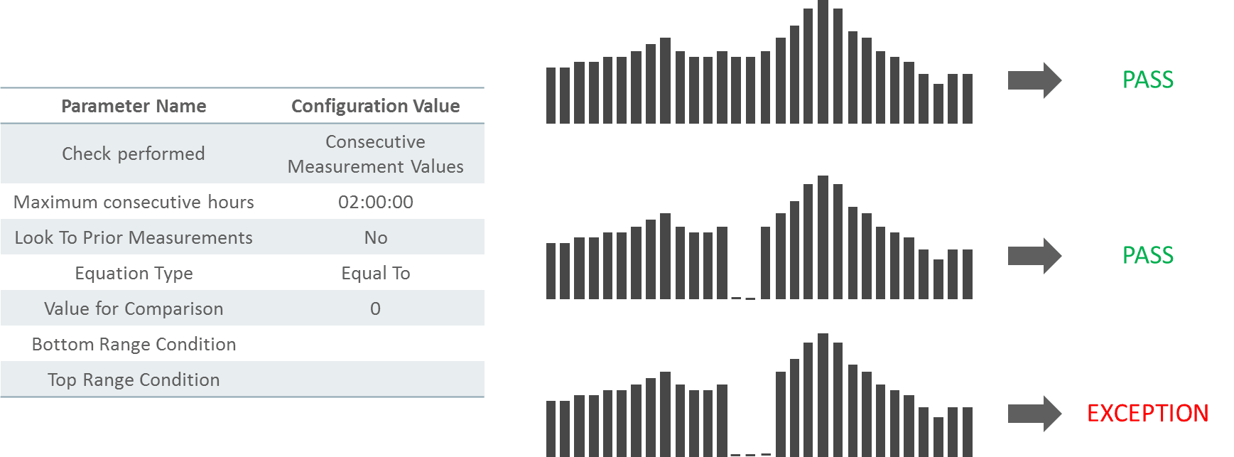

Scenario 1: Rule configured to fail for zero values

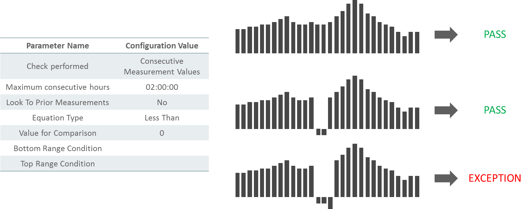

Scenario 2: Rule configured to fail for negative values
Scenario 3: Rule configured to fail for missing condition codes

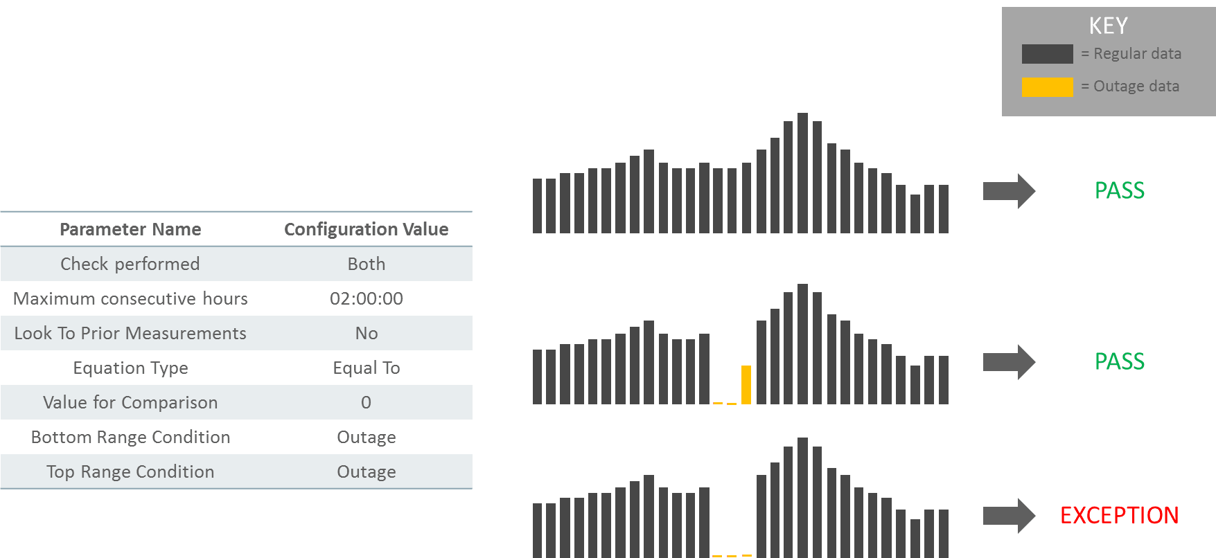

Scenario 4: Rule configured to fail for outage condition codes only if its zero

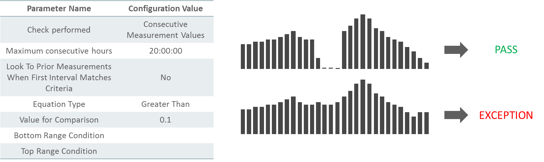

Scenario 5: Rule configured to fail if a long period of consecutive water values are greater than 0.1

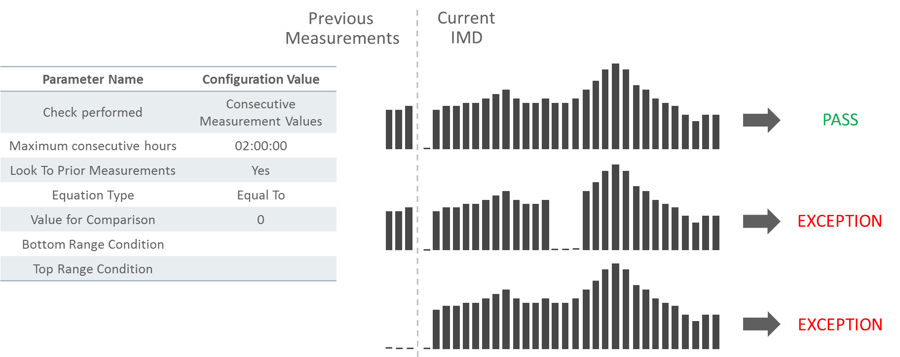

Scenario 6: Look back at prior measurements when the first interval matches criteria
