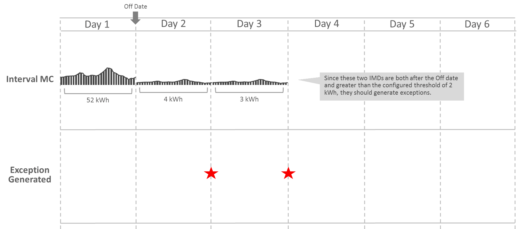

Example 1: Non-zero data during disconnected period
This illustration shows an example scenario of non-zero data during disconnected period .

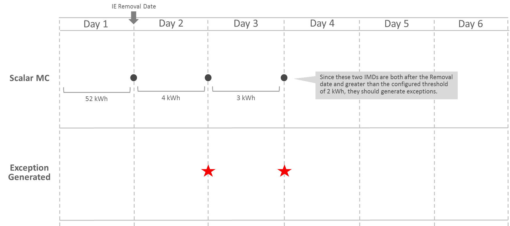

Example 2: Non-zero data after removal date with no new install
This illustration shows an example scenario of non-zero data after removal date with no new install.

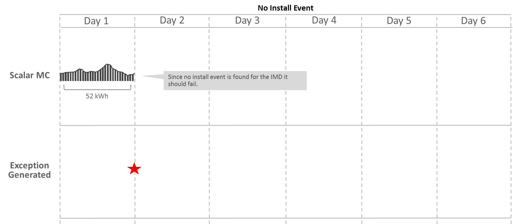

Example 3: Data received when device has no Install Event records
This illustration shows an example scenario of data received when device has no Install Event records.

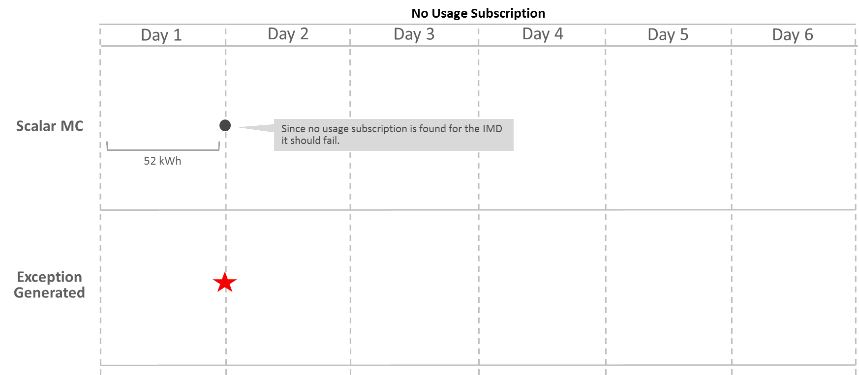

Example 4: Data received when not connected to a Usage Subscription record
This illustration shows an example scenario of data received when not connected to a Usage Subscription record.
