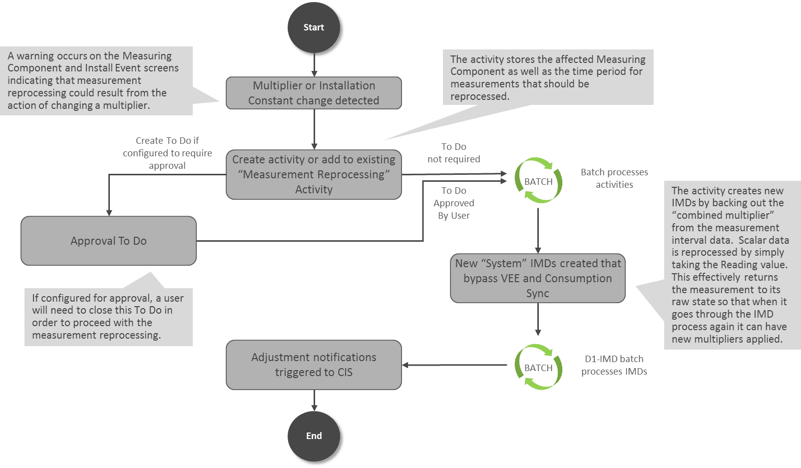

The diagram below helps to provide an overview of Measurement Reprocessing:
This diagram provides an overview of the Measurement Reprocessing module.
