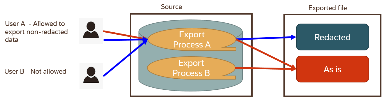

Exporting Non-Redacted Data Requires Security Rights
By default, the export tools redact data based on existing redaction rules. There are situations where certain users may be allowed to export data in its original form, that is, to request to not apply the redaction rules.
Diagram illustrating the two types of processes, which are further described below.
The following points describe the processes for exporting data:
  • Some processes always export data as is, in case the target consumer needs the raw data. This is irrespective of the user requesting the export.
  • Some processes perform data redaction by default and may offer an option for exporting data as is. The option to export data in its original form is secured by application security.
  • In this example, process A supports data redaction by default with an option to export non-redacted data. User A has the right to export the data redacted (default) or explicitly request to export it in its original form. User B does not have the right to do so hence their export content is redacted by default.
The option to export data in its original form is associated with the Do Not Apply Redaction Rules access mode associated with the following relevant application services:
  • For CMA, the additional access mode is associated with the migration data set export's application service. When granted, the user may select the special non-redacted export option when they create the export data set request.
  • For GDE batch processes, the access mode is associated with their application service and is tied to the Do Not Apply Redaction Rules batch parameter they support. Only users with the proper application security can submit these batches using the special batch parameter option
