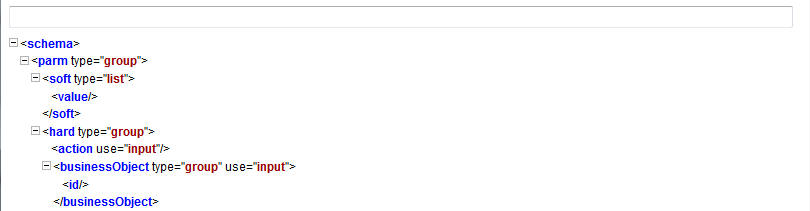

For plug-ins configured to use a script engine version, the best way to understand the script's API is to use the View Script Schema hyperlink to view its parameters data area schema.
The plug-in data area schema
Notice the two groups: soft and hard. If you are familiar with plug-in spots, you'll recognize these as the classic soft and hard parameters:
  • The soft parameters are the values of the parameters defined on the algorithm. Notice they are not named - if you want to reference them in your plug-in script, you must do it by position.
  • The hard parameters are controlled by the plug-in spot (i.e., the algorithm entity). Notice that this plug-in spot has a single input parameter called " businessObject/id". Also notice the use= attribute - this shows that this parameter is input-only (i.e., you can't change it in the plug-in script).
XPath. You can click on an element name to see the XPath used to reference the element in your script.
