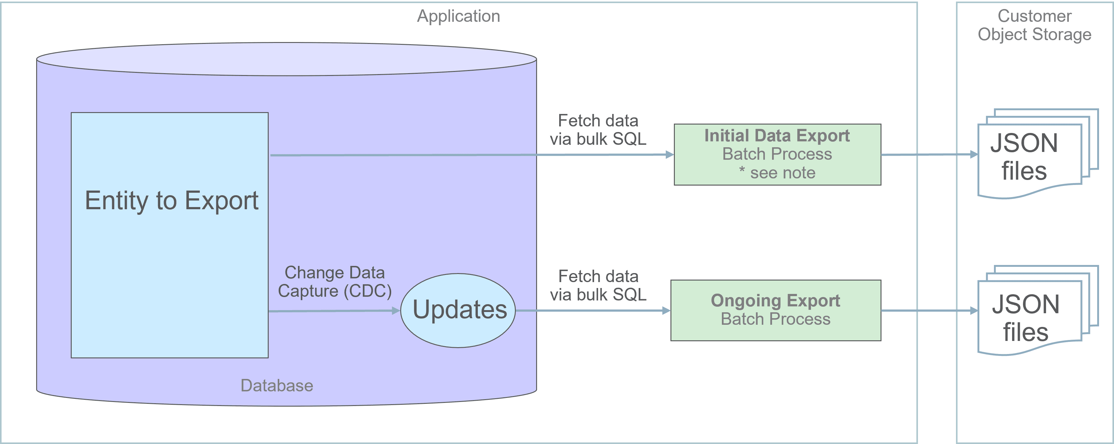

Image depicting the Application on the left and the Customer Object Storage on the right. Within the Application, there is a database that contains the Entity to Export, which in this diagram is connected through an arrow to the Initial Data Export Batch Process outside of the database. The text on the arrow states Fetch data via bulk SQL. There is another arrow from the batch process box to the JSON files within the Customer Object Storage section. The batch process box has a reference to notes related to this step that are described as part of the next overall steps summary. Below this, there is another arrow from the Entity to Export box to a circle labeled Updates, within the database. The text for this arrow reads Change Data Capture (CDC). From the Updates circle, there is the Fetch data via bulk SQL arrow that goes to the Ongoing Export Batch Process, represented by a box outside the database space. This batch process is connected through an arrow to another set of JSON files.
The overall process involves the following steps:
  • Enable entities for export in the Generalized Export Dashboard portal. You may enable many entities at once. This step also allows you to enable ongoing export of these entities.
  • Submit the Generalized Initial Export Initiator (F1-GEXPI ) batch process to export the current content of all enabled entities. This step submits a separate batch process for each entity you have enabled for export.
    A full database export can be used instead. The export file can be imported in the target environment to establish the initial baseline. Cloud customers may contact cloud operations to request such export for on-premise use. This schema export is limited for reporting purposes and is intended for initial extract only.
  • Schedule the Generalized Ongoing Export (F1-GEEXO ) batch process to run periodically.
