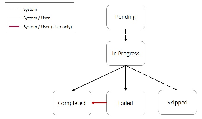

Infrastructure Process Step Lifecycle
In the lifecycle, process steps are created in Pending status and transition to the In Progress status by the process logic. Steps that are in the In Progress status can transition to the Complete, Failed or Skipped status.
A process steps is created in Pending status and is transitioned to In Progress by the process logic when its turn to execute arrives.
When a step is In Progress, the following transitions are possible:
  • Transition the step into Completed status upon successful completion of the step's work or by selecting the Complete action.
  • Transition the step into Failed status when an error was detected during the step's work or by selecting the Fail action.
  • Steps may include logic that will transition the step into Skipped status if that logic determines that the step should not be executed.
When the step is In Progress, selecting the Job Status action will display information about the job running status (if it is a batch job type of step).
Manually changing the step status to Completed or Failed while the step is In Progress should be carefully considered. This should only be done when step stays In Progress status for a long time and upon investigation it is clear that some manual intervention is required.
When a step is in Failed status it is still possible to manually transition the step into Completed status.
Transitioning the step from Failed to Completed status should only be done if it is clear that the step was able to successfully accomplish its task. This will likely be established after some investigation.
