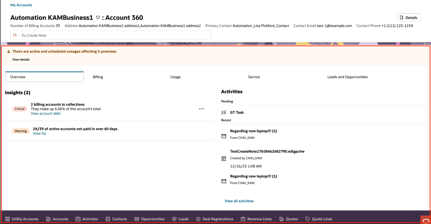

This image shows the Account 360 sub-view displayed within the Redwood Sales Account Details page:
Figure 11-1 Redwood Sales Account 360
This image shows the Redwood Sales Account Detail screen with the Account 360 sub-view.

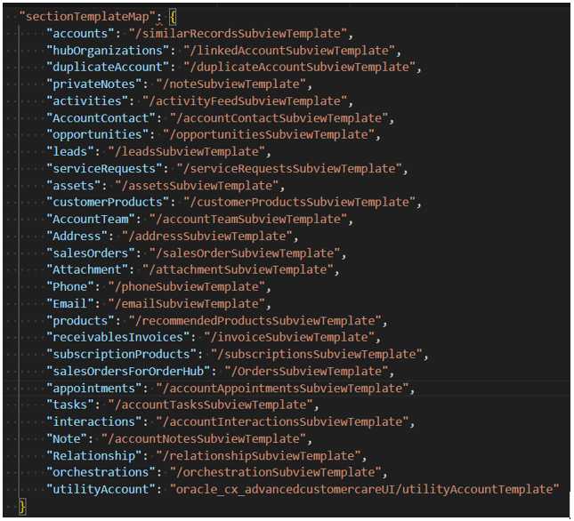

  8. In the sectionTemplateMap of the duplicated layout, add the following:
    "utilityAccount":
                            "oracle_cx_advancedcustomercareUI/utilityAccountTemplate"

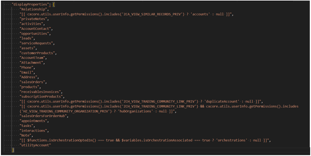

  9. In the displayProperties add:
    "utilityAccount"

The following images show the full list of displayProperties and sectionTemplateMap:
Figure 11-2 Redwood Sales Properties
This image shows the full list of properties.
Figure 11-3 Redwood Sales Properties (Continued)
