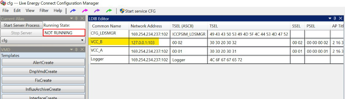

Now we will use the LDIB Editor in the Central panel to specify the address of the remote VCC for each server configuration. In this case for both server configurations, the remote ICCP peer’s IP address will be the LOCALHOST address, 127.0.0.1, because we are running both configurations on the same machine.
Note: If we were using a prototype VMD to create VCC_A and VCC_B then we could specify this information in a batch file.
To update the Cfg configuration’s remote peer’s IP address in the LDIB Editor:
  1. Select the cfg alias from the Configuration Alias drop-down menu.
  2. Open the LDIB Editor tab in the Central panel.
  3. For the row associated with VCC_B in the Common Name column, change the value for Network Address to 127.0.0.1:103.
Image LDIB Editor VCC_A
