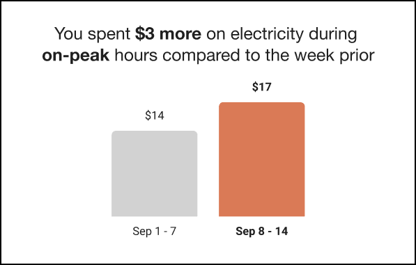

This image shows an example of the module:
Example of the Weekly Comparison module.

When used in Load Shifting reports, the insight statement varies as follows, based on whether the customer spent more, less, or about the same this week:
  • You spent [$X] more on electricity during peak hours this week.
  • You spent [$X] less on electricity during peak hours this week.
  • You spent about the same on electricity during peak hours this week.
