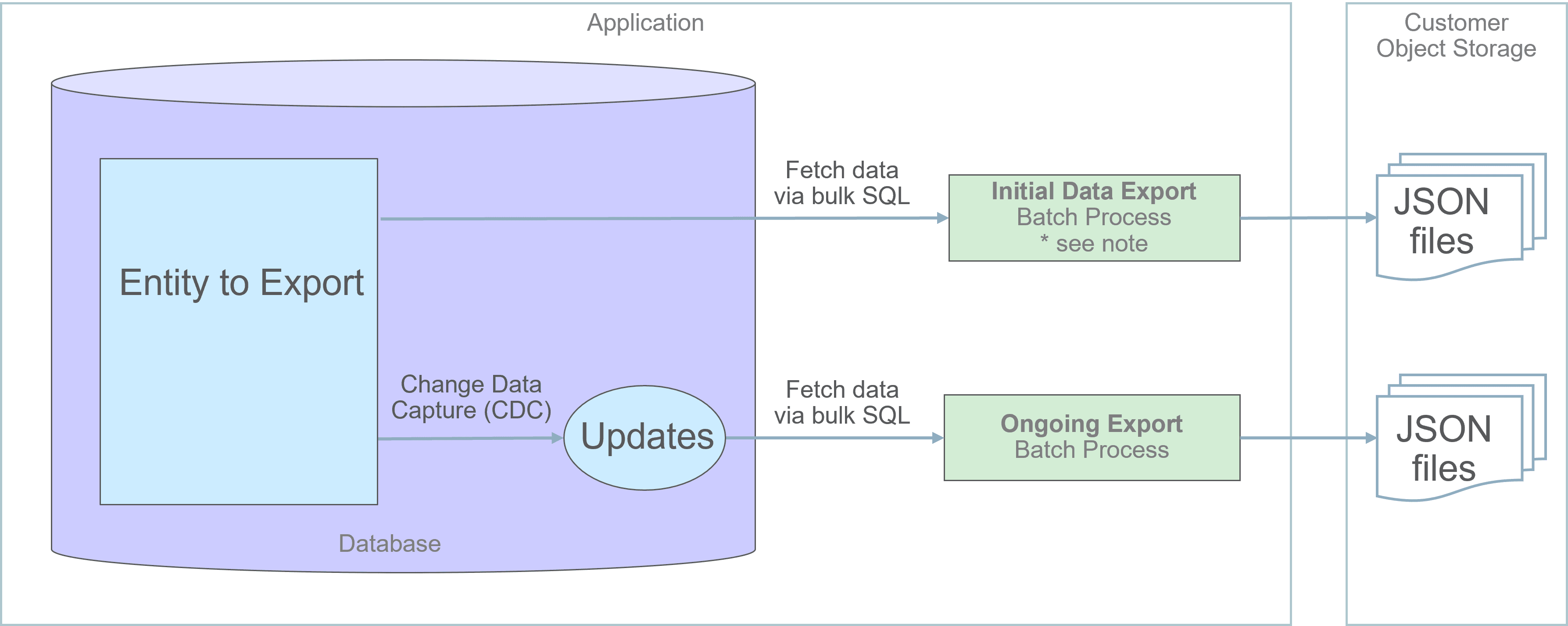

The generalized data export method provides a file-based export of data in JSON format. Exporting the data of a maintenance object using this method involves an initial export of the entity’s entire data followed by an ongoing export of changes as they are made over time. These processes are illustrated in the following diagram:
Enable entities for export in the Generalized Export Dashboard portal. You may enable many entities at once. This step also allows you to enable ongoing export of these entities.
Submit the Generalized Initial Export Initiator (F1-GEXPI ) batch process to export the current content of all enabled entities. This step submits a separate batch process for each entity you have enabled for export.
A full database export can be used instead. The export file can be imported in the target environment to establish the initial baseline. Cloud customers may contact cloud operations to request such export for on-premise use. This schema export is limited for reporting purposes and is intended for initial extract only. -
Schedule the Generalized Ongoing Export (F1-GEEXO ) batch process to run periodically.

Data changes are tracked by the Capture Change for Ongoing Export (F1-MO-REGCHN) Maintenance Object Audit algorithm. The algorithm records the prime key of a changed entity in a designated Data Export Update table that serves as a queue of changed entities to export. The queue is later on consumed by the ongoing data export batch process.
The Maintenance Object Audit plug-in spot is capable of tracking changes made to the entity by any layer of the application. Making changes using direct SQL would bypass this mechanism and therefore should be avoided.The audit rule is added to a maintenance object when the ongoing data export option on its corresponding data export control record is enabled. In the same way the audit rule is removed from the maintenance object when the ongoing export option is disabled.
The ongoing export option has to be enabled on the data export control record for the entity before it is initially exported. This ensures changes made while the initial export process is in progress are not missed.Unlike the initial export batch process that requires a batch control to be defined for each eligible maintenance object, a single batch process is used to export ongoing changes made to all entities.
All changes queued in the Data Export Update table are exported to a designated ongoing export file. Refer to the Managing a Large Backlog section for more information.
A full snapshot of the data related to the changed entity is exported to avoid heavy data merging on the target side.
Once exported, records are deleted from the Data Export Update table.
