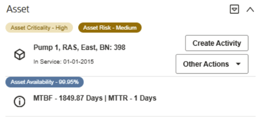

Asset Zone
The Asset zone displays the common actions that can be taken for the asset, asset and location information, and insights for Asset Criticality, Asset Risk, and Asset Availability.
Example of an Asset Zone.
Insight Group
An insight group is required to display Asset Info and Actions, an Asset Criticality badge, an Asset Risk badge and an Asset Availability insight, including the Mean Time Between Failure (MTBF) and Mean Time To Restore (MTTR) information.

Asset Info and Actions Insight
Example of Asset Info and Actions Insight
The common action buttons are available using the Asset 360 Info and Actions insight type. No additional setup is required to display this insight. Available buttons and actions are as follows:
  • Create Activity
  • Create WO from Template
  • Create Work Order
  • Create Work Request
  • View in Map - this action is available only for GIS sync'd assets and locations
Asset Availability Insight
Example of Asset Availability Insight

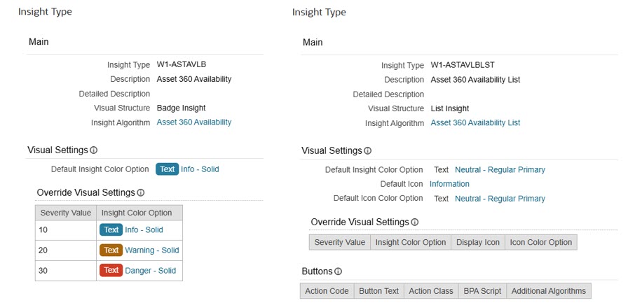

The Asset Availability insight is a pair of insight types to display both a badge and a list. It displays the percentage the asset has been operational (up and running) during the Inservice/Installed life of the asset. It also displays the Mean Time Between Failure and Mean Time To Restore information.
Example of the Asset Availability Insight Type
By default:
  • If the asset availability is 75% and over, a blue badge (defined as the default insight color) is displayed.
  • If the asset availability is between 51% and 74%, an orange badge (override severity value = 20) is displayed.
  • If the asset availability is 50% and below, a red badge (override severity value = 30) is displayed.
Update the Asset 360 Availability (W1ASTAVLB) algorithm to override the default behavior above.
Example of Asset Availability Parameter Values
