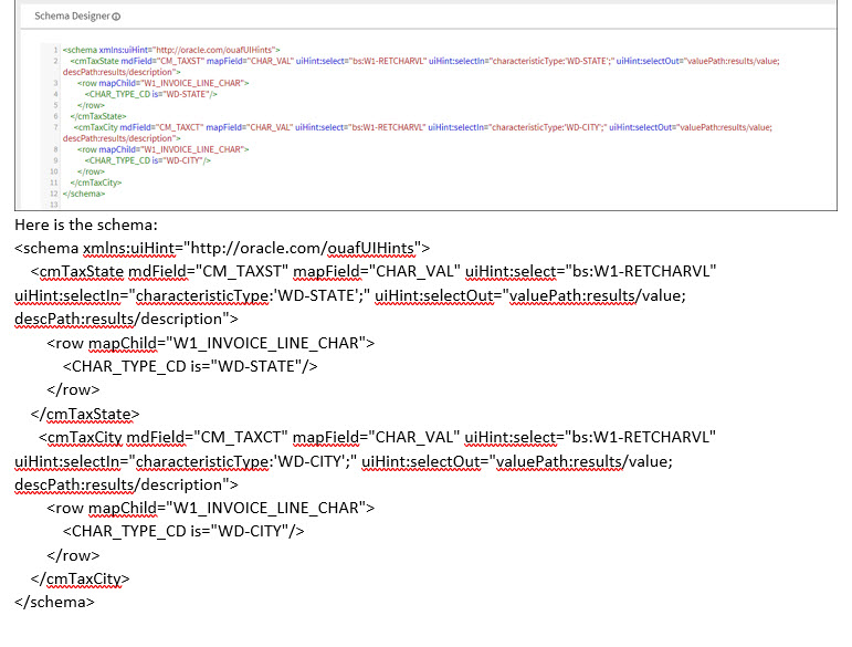

Each jurisdiction has its own applicable taxes so implementations will need to extend the system to add the taxes that are applicable for them. One way to extend the system is to use the Data Area (DA) Extension to extend the base Business Object (BO).
- You will need one DA for each business object you want to extend and the element name for every
type of tax must match across all the DAs.
- Find the Data Area that needs to be extended for the BO.
- Drill into the Maintenance Object to discover the table the Characteristic would reside on.
- Navigate back to the business object's Schema tab and copy the Data Area for the Tax Information zone.
- Create a new custom Data Area and indicate what data it is extending (Prefix your element names with "cm" to avoid upgrade issues).
- Return to the Schema tab and enter the schema to match your Fields and Factors.
- Here is an example Schema:
Please see the Framework section of this guide for more information on Data Areas.
