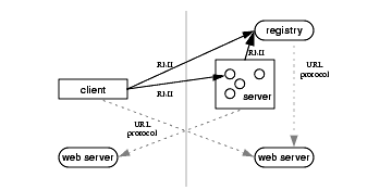

2.1 Distributed Object Applications
RMI applications are often comprised of two separate programs: a server and a client. A typical server application creates a number of remote objects, makes references to those remote objects accessible, and waits for clients to invoke methods on those remote objects. A typical client application gets a remote reference to one or more remote objects in the server and then invokes methods on them. RMI provides the mechanism by which the server and the client communicate and pass information back and forth. Such an application is sometimes referred to as a distributed object application.
Distributed object applications need to:
- Locate remote objects - Applications can use one of two mechanisms to obtain references to remote objects. An application can register its remote objects with RMI's simple naming facility, the - rmiregistry, or the application can pass and return remote object references as part of its normal operation.
- Communicate with remote objects - Details of communication between remote objects are handled by RMI; to the programmer, remote communication looks like a standard method invocation.
- Load class bytecodes for objects that are passed as parameters or return values - Because RMI allows a caller to pass objects to remote objects, RMI provides the necessary mechanisms for loading an object's code as well as transmitting its data.
The illustration below depicts an RMI distributed application that uses the registry to obtain references to a remote object. The server calls the registry to associate a name with a remote object. The client looks up the remote object by its name in the server's registry and then invokes a method on it. The illustration also shows that the RMI system uses an existing web server to load bytecodes of classes written in the Java programming language, from server to client and from client to server, for objects when needed. RMI can load class bytecodes using any URL protocol (e.g., HTTP, FTP, file, etc.) that is supported by the Java platform.

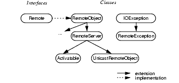

2.4 Overview of RMI Interfaces and Classes
The interfaces and classes that are responsible for specifying the remote behavior of the RMI system are defined in the java.rmi package hierarchy. The following figure shows the relationship between several of these interfaces and classes:
2.4.1 The
java.rmi.Remote Interface
In RMI, a remote interface is an interface that declares a set of methods that may be invoked from a remote Java virtual machine. A remote interface must satisfy the following requirements:
- A remote interface must at least extend, either directly or indirectly, the interface - java.rmi.Remote.
- Each method declaration in a remote interface or its super-interfaces must satisfy the requirements of a remote method declaration as follows: - A remote method declaration must include the exception - java.rmi.RemoteException(or one of its superclasses such as- java.io.IOExceptionor- java.lang.Exception) in its throws clause, in addition to any application-specific exceptions (note that application specific exceptions do not have to extend- java.rmi.RemoteException).
- In a remote method declaration, a remote object declared as a parameter or return value (either declared directly in the parameter list or embedded within a non-remote object in a parameter) must be declared as the remote interface, not the implementation class of that interface.
The interface java.rmi.Remote is a marker interface that
defines no methods:
public interface Remote {}A remote interface must at least extend the interface
java.rmi.Remote (or another remote interface that extends
java.rmi.Remote). However, a remote interface may extend a

2.4.3 The
RemoteObject Class and its Subclasses
RMI server functions are provided by
java.rmi.server.RemoteObject and its subclasses,
java.rmi.server.RemoteServer and
java.rmi.server.UnicastRemoteObject.
- The class - java.rmi.server.RemoteObjectprovides implementations for the- java.lang.Objectmethods,- hashCode,- equals, and- toStringthat are sensible for remote objects.
- The methods needed to create remote objects and export them (make them available to remote clients) are provided by the class - UnicastRemoteObject.
- The - java.rmi.server.UnicastRemoteObjectclass defines a singleton (unicast) remote object whose references are valid only while the server process is alive.
