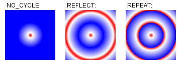

The following code demonstrates typical usage of RadialGradientPaint, where the center and focus points are the same:
     Point2D center = new Point2D.Float(50, 50);
     float radius = 25;
     float[] dist = {0.0f, 0.2f, 1.0f};
     Color[] colors = {Color.RED, Color.WHITE, Color.BLUE};
     RadialGradientPaint p =
         new RadialGradientPaint(center, radius, dist, colors);
This image demonstrates the example code above, with default (centered) focus for each of the three cycle methods:
image showing the
 output of the sameple code

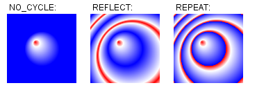

It is also possible to specify a non-centered focus point, as in the following code:
     float radius = 25;
     Point2D focus = new Point2D.Float(40, 40);
         new RadialGradientPaint(center, radius, focus,
                                 dist, colors,
                                 CycleMethod.NO_CYCLE);
This image demonstrates the previous example code, with non-centered focus for each of the three cycle methods:
image showing the
 output of the sample code
