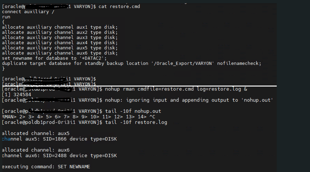

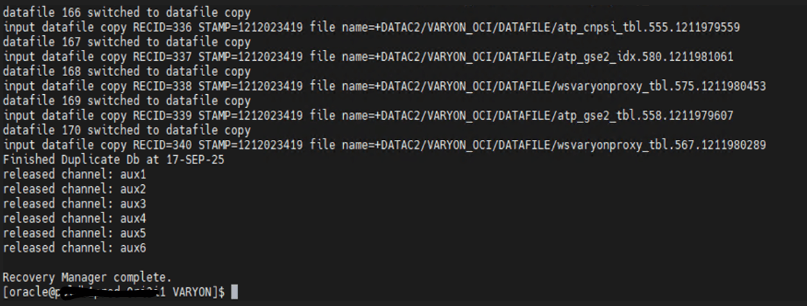

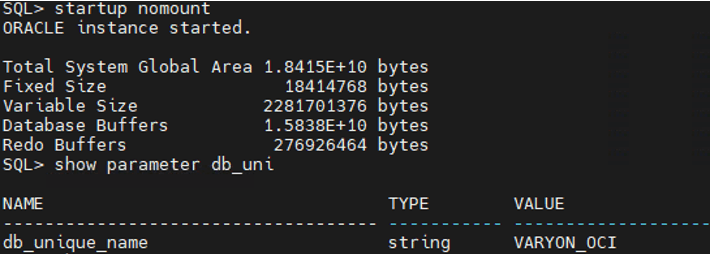

Task 2: Start database NOMOUNT in stage DB and start restoring the database in OCI.
- Start database in nomount mode.
- To run Database Restore script in background mode.

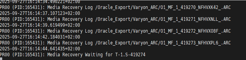

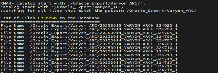

Task 3: Once the restore is complete, copy all archive logs from the source database to the NFS location until the cutover.
MRPshould be enabled on the target standby database.- Catalog archive directory path and applying logs on the target database.
MRPwill pick these archive logs and start recovery after cataloging archive logs.

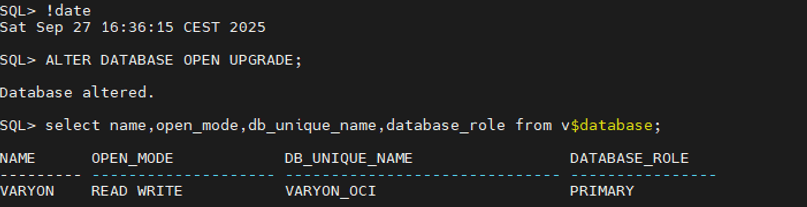

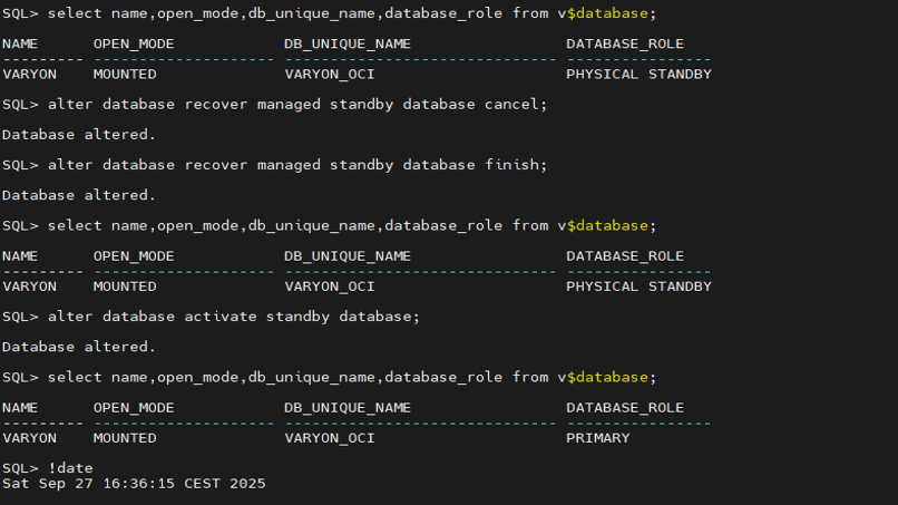

Task 4: Stop recovery, activate the standby database, and open the database in OPEN UPGRADE mode in the target DB system.
- To stop the
MRPProcess and activate standby database in source database.
- To open database with upgrade mode.

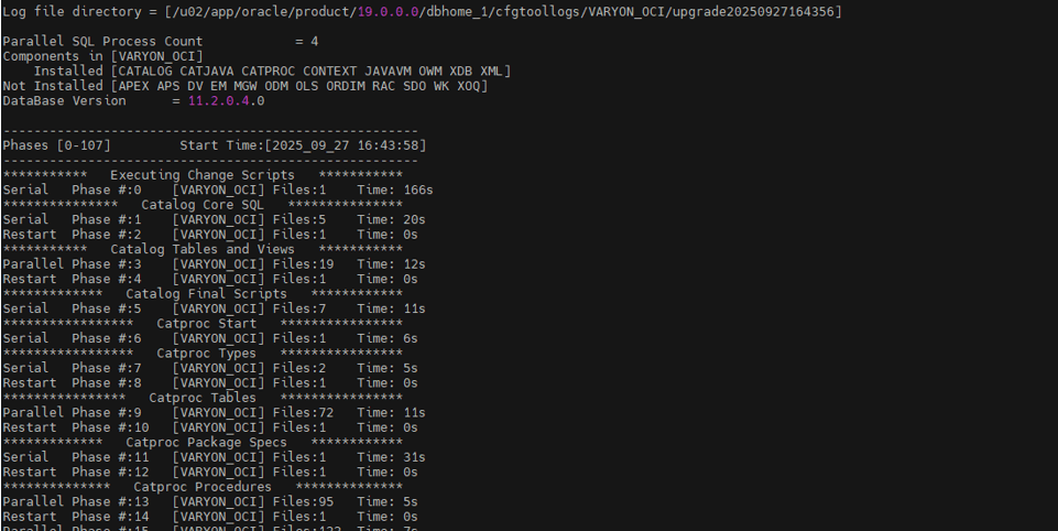

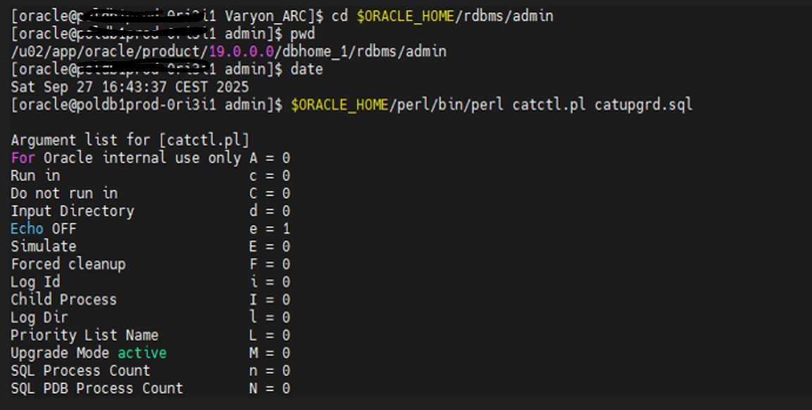

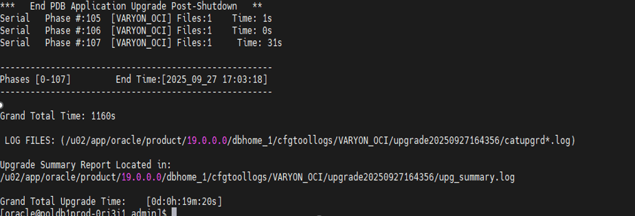

Task 5: Upgrade the stage database to the 19c version within the target database system.
- To run the upgrade script on the
Source DBsystem.

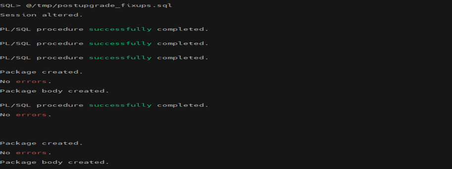

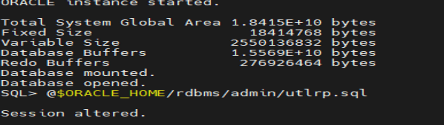

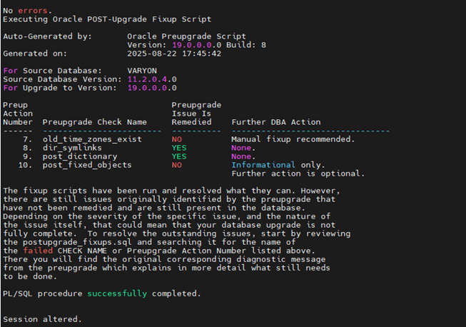

Task 6: Start the database, run the post-upgrade fixup script, and run the UTLRP command to compile invalid objects.
- Log in to the Target DB system and start the DB & run the
utlrpcommand on the target DB system.
- To run the post-upgrade fixup script in the target DB system.

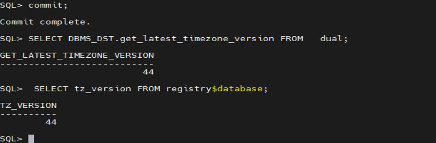

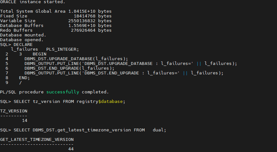

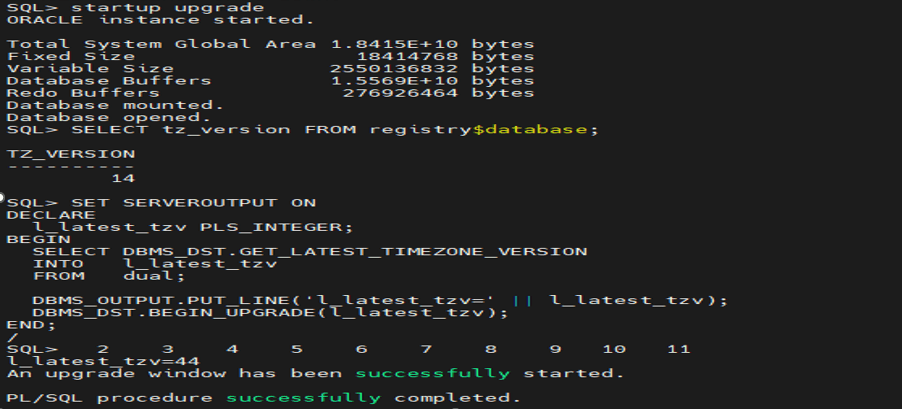

Task 7: Upgrade the time zone on the stage database.
- start DB in
upgrademode.
- Upgrade the time zone in the stage database before plugging the non-CDB into the
CDB.

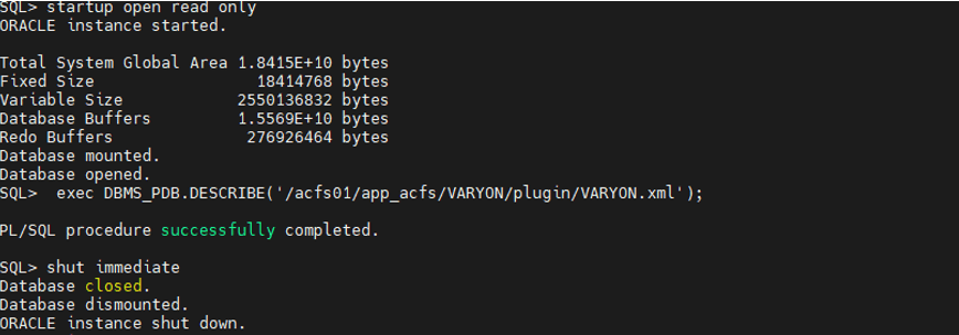

- Start the database in read-only mode and create an XML file for
PDBplugging.

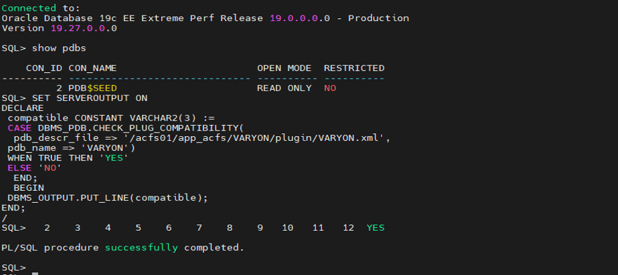

- To check compatibility on the target
CDBdatabase before the plug-in. It should showyesas a result.

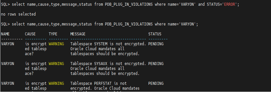

- Check if there are any errors for
PDBplugin violations. We can ignore warnings for tablespace encryptions.

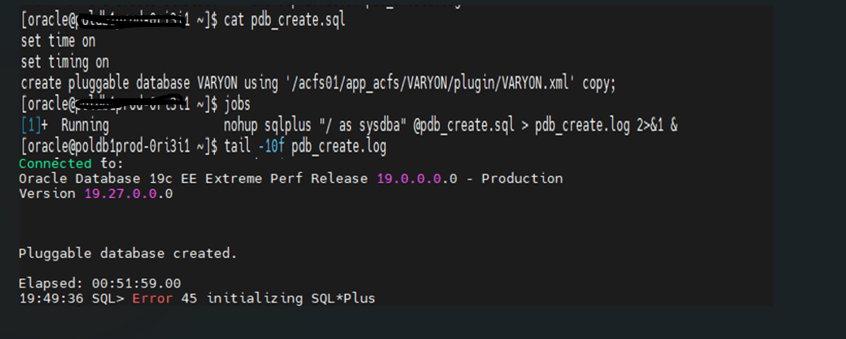

- To run a script to create a pluggable database on the target
CDBand run in background mode.

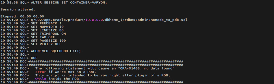

- To run the
noncdb_to_pdb.sqlscript after thePDBplug-in in the target DB system.

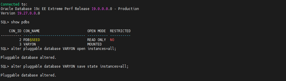

- To open the
PDBdatabase and set the save state for all instances.

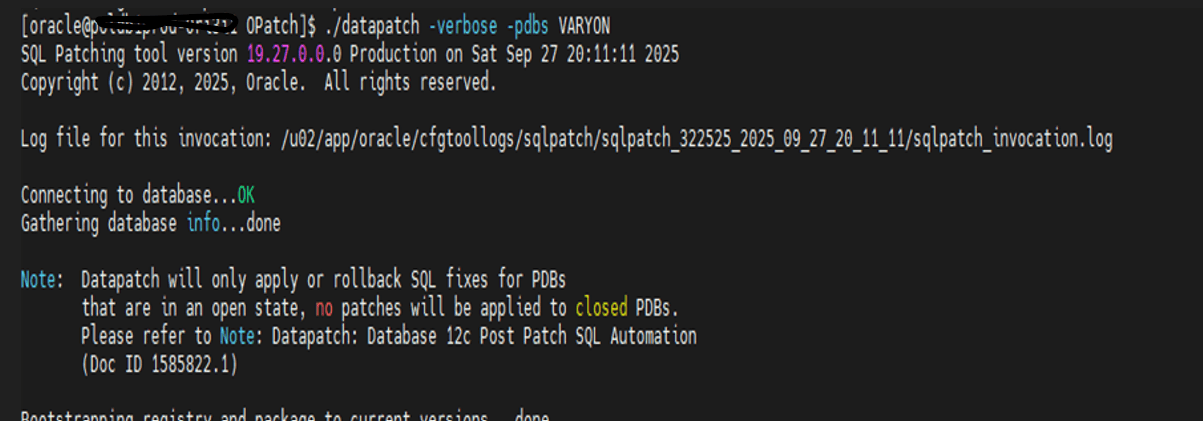

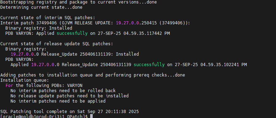

- To run
datapatchto apply current patches on thePDBdatabase in the target DB system.

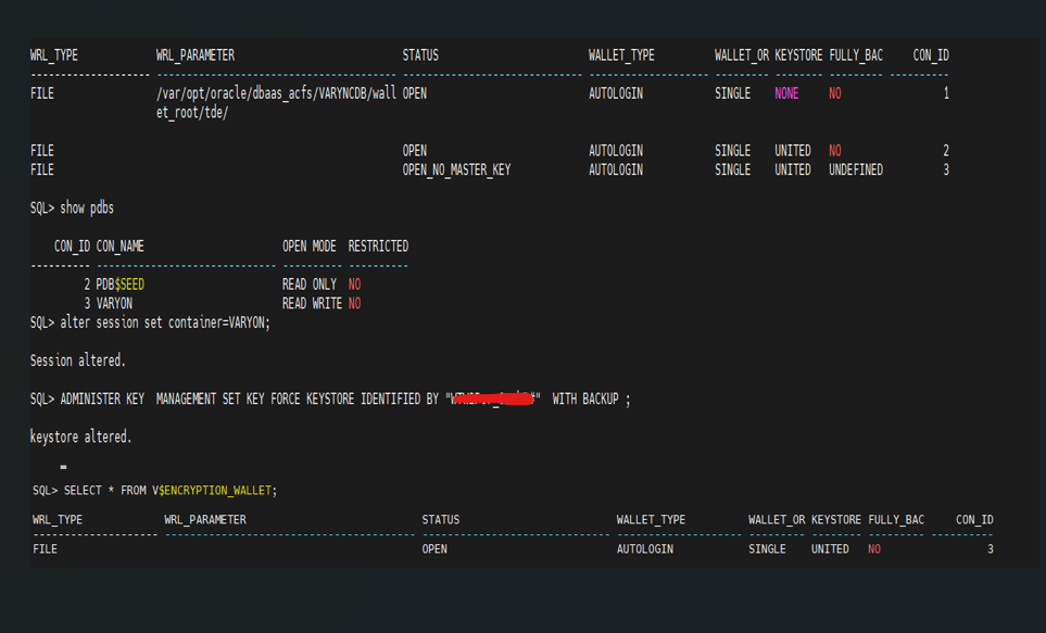

Task 9: Encryption key for PDB database.
- Set the encryption key for the
PDBdatabase.

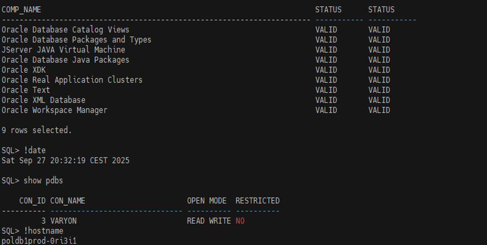

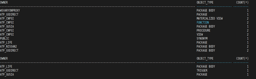

Task 10: Ensure that the components of the database registry are validated for post-checks.
- To validate DB components
