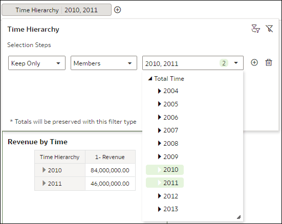

  • Members
    Level hierarchy example: For a table showing revenue for a time dimension, if you use a selection step with the action Keep Only, the operator Members, and the members 2010 and 2011, the table shows the revenue for only those two years.
    Description of selection-steps-lvlhierarchy-ex-members.png follows

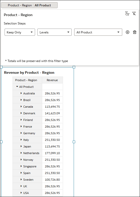

  • Nulls - Lets you specify the hierarchy levels for which to include or exclude null values.
    Level hierarchy example: For a table showing revenue for a product-region hierarchy, you can start with a selection step with the action Keep Only, the operator Levels, and the level All Product, then expand All Product in the table so that all named regions and their revenue are displayed.
    Description of selection-steps-lvlhierarchy-ex-nulls1.png follows
    If you add another selection step with the action Add, the operator Nulls, and the level Region, the table not only shows the revenue for the named regions, but also shows the revenue for any unnamed regions (in other words, those regions with null values).
    Description of selection-steps-lvlhierarchy-ex-nulls2.png follows
