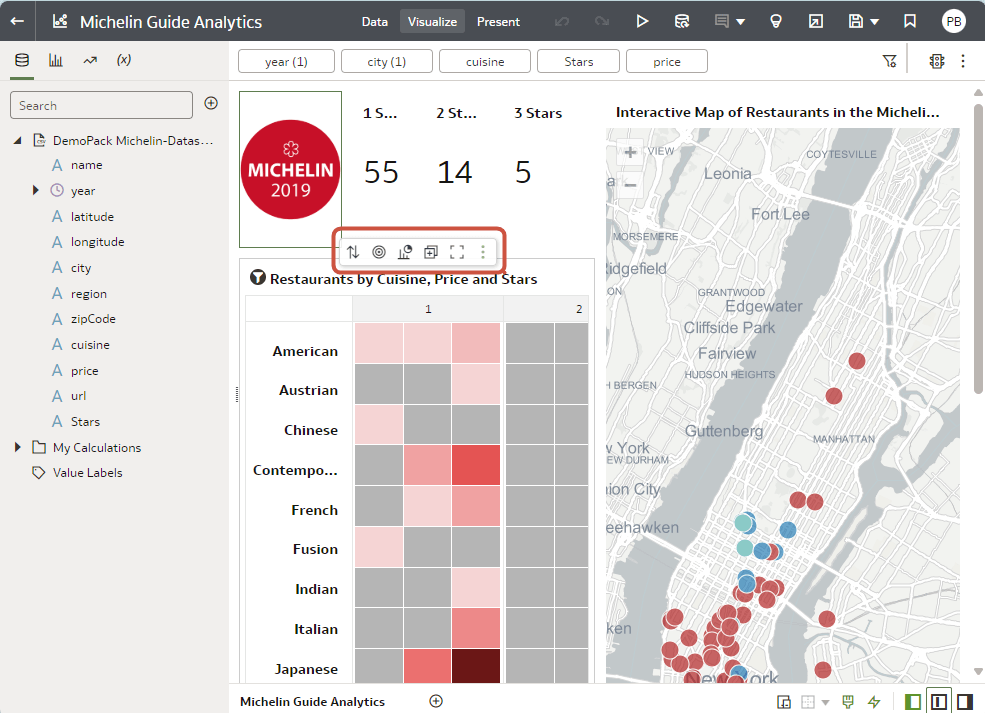

Access visualization options
The visualization toolbars provide quick access to formatting and editing options, and a menu (Ellipsis icon for Menu) with additional options.
Description of viz-options.png follows
Access the visualization menu
Hover over a visualization, and click Menu (Ellipsis icon for Menu) to access editing options.
