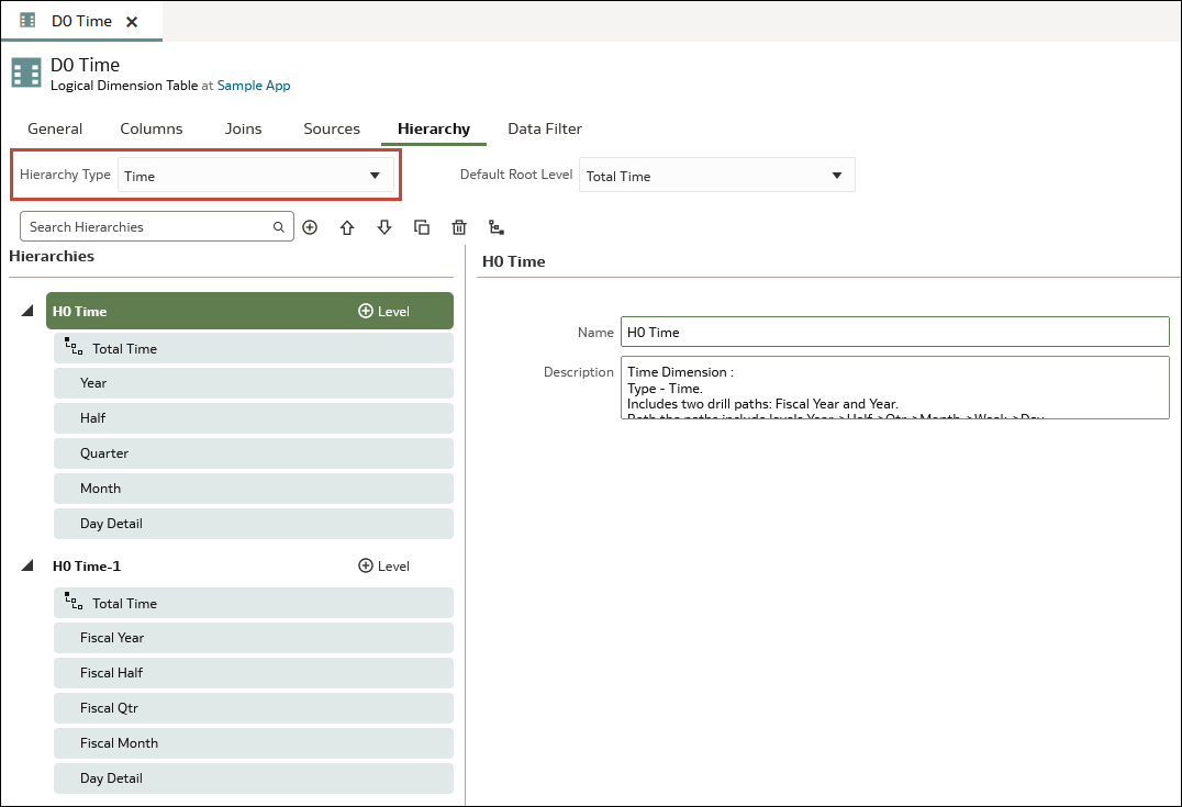

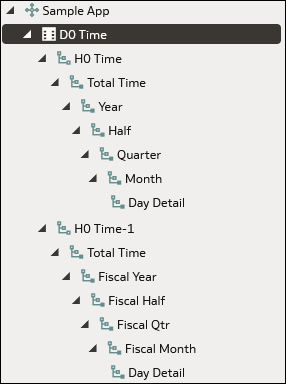

A time dimension is a special level-based hierarchy that is used specifically for time-based hierarchies. A time dimension is required if you want to use time series calculations such as
AGOandTODATE. To define a time dimension, you select Time in the properties of the dimensional hierarchy. -

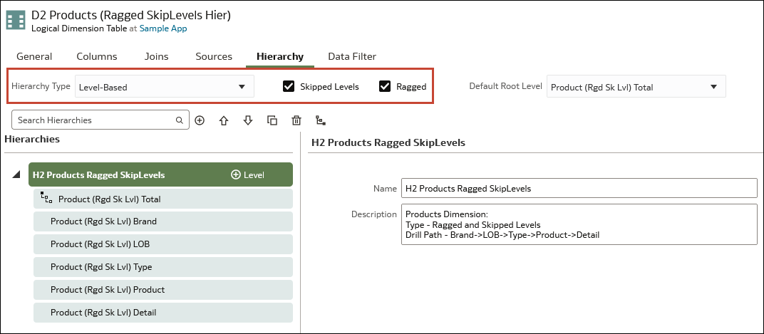

A ragged or unbalanced hierarchy is another special level-based hierarchy where not all the data is present at all levels of the hierarchy. To define a ragged hierarchy, you select Ragged in the properties of the hierarchy.
This example shows a ragged and skipped-level hierarchy where the Distributor and Store levels are missing from the Web branch of the hierarchy.
Description of the illustration ceal_hierarchies_4.jpgHere, you select both Ragged and Skipped Levels in the properties of the hierarchy.

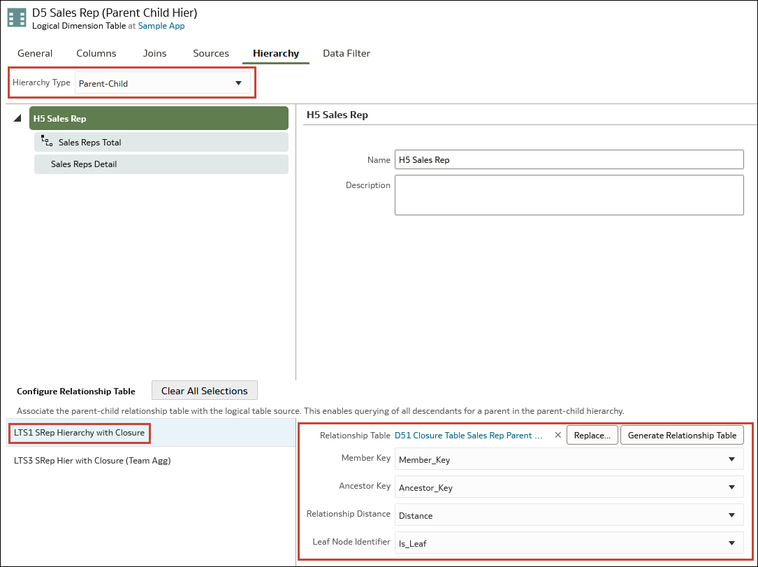

A parent-child hierarchy is a type of hierarchy often associated with an organization. For example, employees rolling up to a manager. In a parent-child hierarchy, each child member rolls up to a single parent member. At the lowest level, each member has no child members. At the highest level, there is a single parent with no further parent levels. In between, each member is both a parent and a child.
Parent-child hierarchies are based on a specialized parent-child relationship table made up of four columns:
- Member
- Ancestor or ancestors of a member
- Number of levels between the member and the ancestor
- If the member is a leaf member, that is, at the lowest level
To define a parent-child hierarchy, you select Parent-Child Settings to set up the hierarchy as shown here.

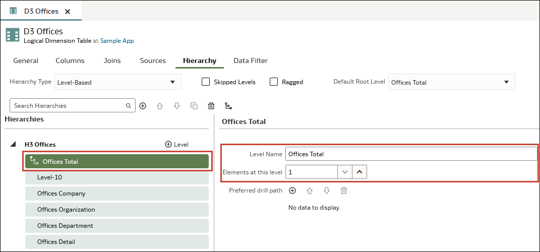

A dimensional hierarchy can contain only one grand total.
If a dimensional hierarchy has multiple branches, all branches typically have a common beginning point and a common end point.
To define the grand total-level, you must select the grand total level and set its Elements at this level property to 1.

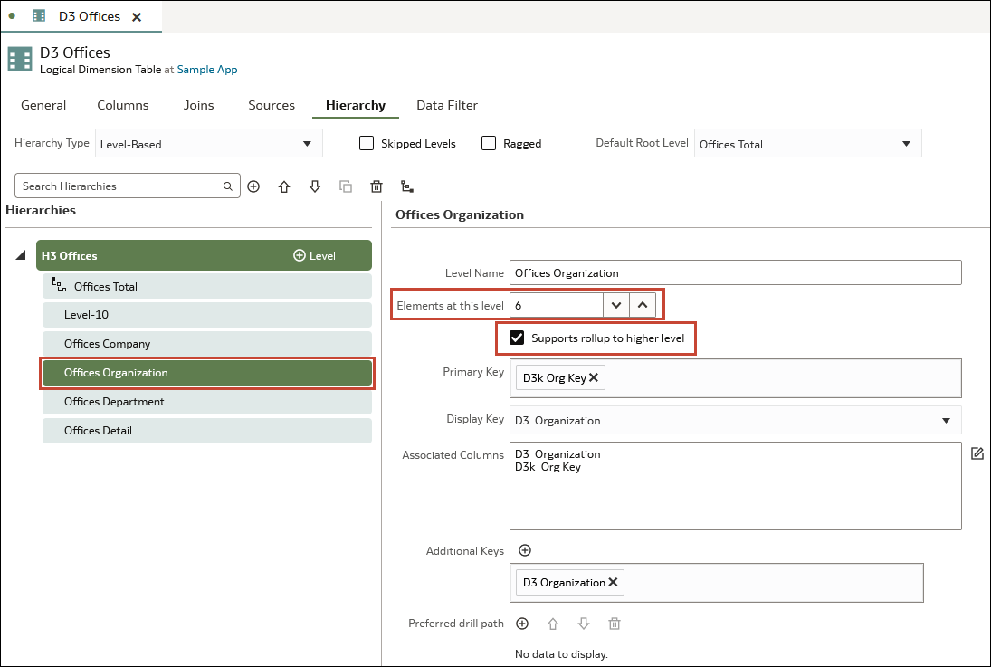

To define a non-grand total levels, you must select the Supports rollup to higher level field in the level's properties. Note that after you define a grand total level for the hierarchy, Oracle Analytics automatically sets the Supports rollup to higher level property for all other levels in the hierarchy.
For all non-grand total levels, the value in the Elements at this level property is always higher than 1.

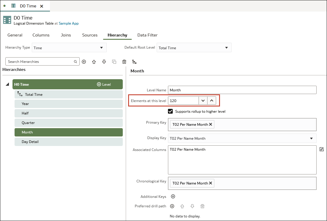

When you define a dimensional hierarchy, always specify the number of elements per level. Oracle Analytics uses the number of elements to identify aggregate tables and mini dimensions. This number doesn’t need to be exact; a rough estimate is sufficient. In navigation, a cross product is calculated across all the content levels in a logical table source. This is used as a tie-breaker when navigating between otherwise equal sources.
The number of elements per level is hierarchical with the lowest number of elements at the top (for a grand total, this number is 1). Higher levels in a dimensional hierarchy should have fewer elements than lower levels. Note that the consistency checker warns you if a parent level has a greater number of elements than a child level.
This example shows a logical level Month with 120 elements defined.

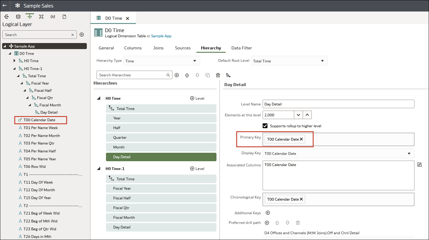

If a column is a primary level key or part of a primary level key, you must assign that column to that level. If a column is a level key in a parent level and part of a composite level key in a child level, you assign that column to the parent level. Using the earlier example, month number and month name should be assigned to the month level and year to the year level.
If a dimensional hierarchy is for a time dimension, at least one of the levels must have a chronological key which specifies the sort order of the periods from the oldest to the newest. Often the primary key of the detail level is also the chronological key.
This example shows a time dimension level key with the same primary key and chronological key.
