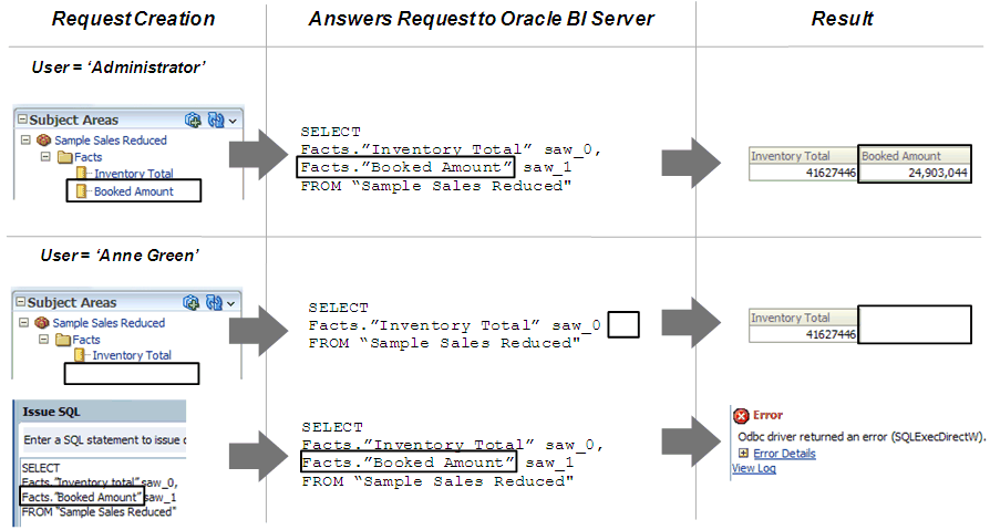

You can use object permissions to configure data filters for objects in the logical layer by using functional groups for multiple application roles.
The object permissions you set determine the security rules that Oracle Analytics applies to client queries. These permissions can't be breached, even when the Logical SQL query is modified.

Select individual objects such as subject areas, presentation tables, or presentation columns in the presentation layer and assign data access for specific application roles.

If you explicitly deny access to an object that has child objects, application roles are denied access to the child objects. For example, if you explicitly deny access to a particular logical table, you're implicitly denying access to all of the logical columns associated with that table.
