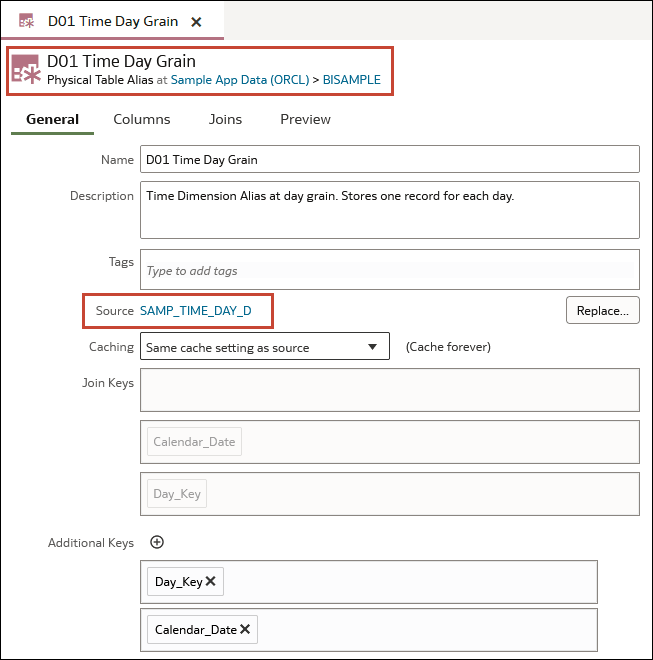

In Oracle Analytics, you can create aliases for tables in the physical layer of your semantic model. Table aliases are useful when a single table has several different roles in the semantic model.

Start by creating an alias. Each physical table should have at least one alias. Only the alias will be used and not the original table. This way if you need new instances of the same table for other roles in the future, it’s easy to identify the differences and roles of each alias.

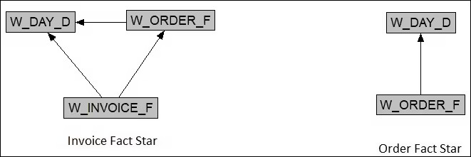

This example shows three tables. Table
W_ORDER_F
is used as a fact table for order metrics, a dimension for order attributes, and it includes theOrder Date
. There is also calendar tableW_DAY_D
, and invoice tableW_INVOICE_F
that includesOrder ID
andInvoice Date
. The invoice table is joined to the order table to retrieve order attributes as a dimension forInvoice Fact
metrics. Note that Oracle Analytics generates separate sub-queries for each fact table. Therefore, we must considerOrder Fact Star
andInvoice Fact Star

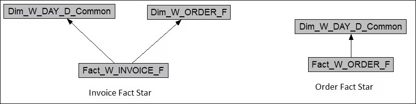

separately, as shown in the diagram.Without any aliases, the diagrams look like this:
Description of the illustration ceal_table_alias_example2.jpgThis configuration causes similar data integrity issues to the Employee example, that is, the
Order Date
isn't equal toInvoice Date
but they're both joined to the same date column on the calendar table.The solution is to create two aliases for the Order table: one alias for the fact and the second alias for the dimension. With aliases the diagrams look like this:
Description of the illustration ceal_table_alias_example2_with.jpgNow there's no conflict between the joins, as the dimension alias of the Order table isn't joined to the calendar dimension.
Also note that there’s no need to join
Fact_W_ORDER_F
withDim_W_ORDER_D
. Except for rare specific situations, you should never join two aliases of the same table together. While doing so doesn’t impact data integrity, it's useless and impacts performance.Instead, create two logical table sources in the
