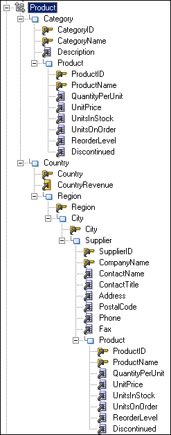

For example, suppose your model contains a logical hierarchy called Product and it contains the two hierarchies named Category and Country:
In the logical layer, Semantic Modeler models this logical hierarchy as a single dimension object that contains multiple hierarchies. In the presentation layer, Semantic Modeler models this dimension as two separate objects: one that displays the drill path through the Category level, and another that shows the drill path through the Country level:
