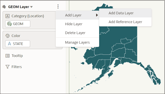

  1. In the Grammar pane, click Layer Options for an existing layer, click Add Layer, and then select Add Data Layer.
    Note that geometry columns can be used only in a data layer. If you need to use them in a reference layer, you must generate a GeoJSON file to support that reference layer.

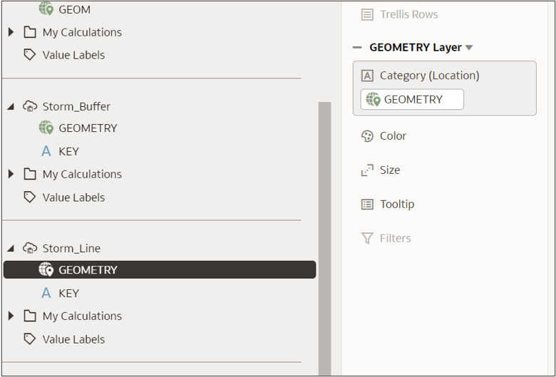

  2. In the Data pane, locate the dataset from which the new layer needs to be overlaid and drag the geometry column Geometry column to the new data layer.

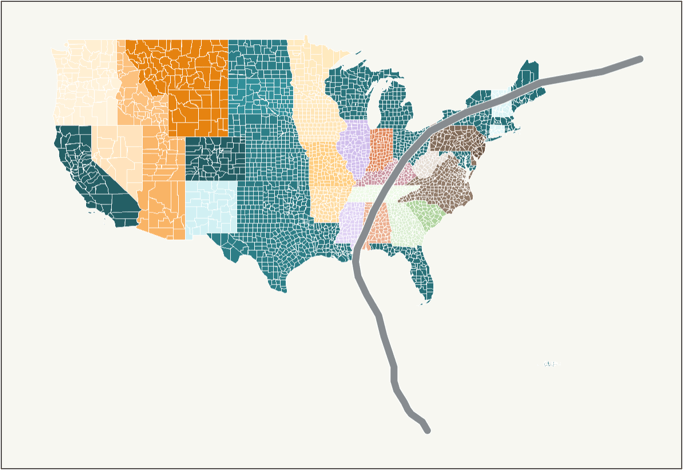

    This example visualizes the new data layer over the existing one and shows how the Storm Line layer is added on top of US Counties.
