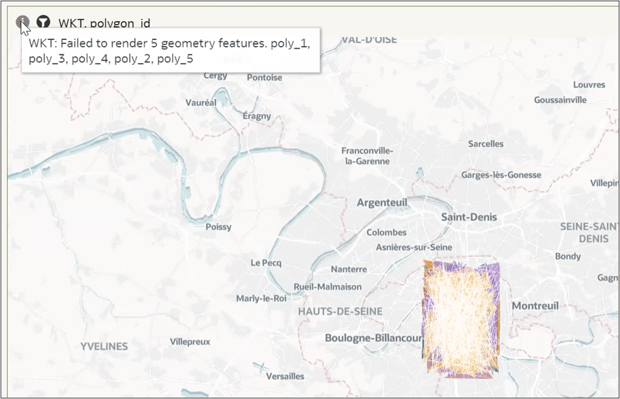

For example, shapes or polygons that are greater in size than 128 KB (per record) aren’t displayed in the map visualization. In this case, the Information icon (The Information icon before it's clicked.) appears toward the bottom right of the map visualization. When you click the icon, its color changes from grey to green (After you click the Information icon, it turns on the Information option near the title of the map visualization.) and turns on the Information option near the map visualization title. When you hover over this option, you can see which shapes don't render as part of the layer. The information displayed is more detailed if the attribute ID column is part of the map visualization (as a tooltip, color, or shape).

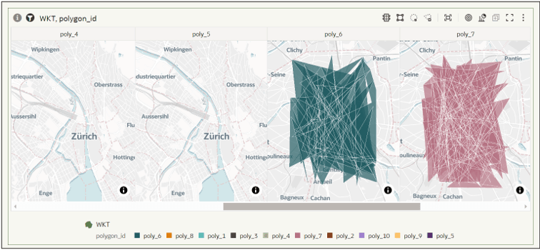

This example shows how the Information option provides more information on shapes that have issues, or that didn’t render.
In this example the polygons are shown in a Trellis Column, and polygons poly_4 and poly_5 aren’t displayed due to shape size beyond 128 KB, whereas poly_6 and poly_7 are displayed since the shape size is within 128 KB.
