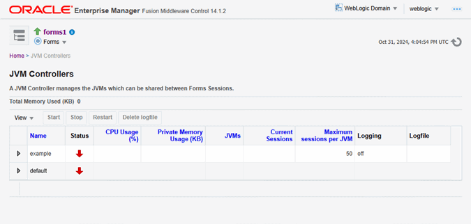

To access the JVM Controller page:
Start the Enterprise Manager Fusion Middleware Control.
From the Forms home page, select JVM Controllers. The JVM Controllers page is displayed.
To start a JVM controller that is not running:
From the Forms menu, select JVM Controllers.
Select the JVM controller that you want to start. A JVM that is not running is indicated by a red, down arrow.
Click Start.
When the JVM controller has started, a green, up arrow is displayed in the Status column.

To stop a JVM Controller:
Select the running JVM controller that you want to stop, indicated by a green, up arrow.
Click Stop.
Click Yes on the Confirmation dialog.
When the JVM controller has been stopped, a red, down arrow is displayed in the Status column.
