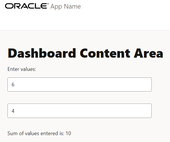

Here we will use the ojet add testing command to configure a testing environment for an Oracle JET app. The app used in this testing demo contains a calculator component that takes two user-submitted numbers, calculates their sum, and displays the result in the app's dashboard. Once the app's testing environment is set up, we will run tests on the calculator component.
First, download the JET-Test-Example.zip and unzip it to your working directory. Open a terminal window in your app's root directory and run the
ojet restorecommand. -
Observe the app's directory structure. In the
/src/ts/jet-compositesdirectory is theoj-calculate-valuecomponent. The tests you will run on the calculator component, after you have configured your app for testing, are included in the app's root directory as the text fileoj-calculate-value-viewmodel-spec-ts.txt.Use the
ojet servecommand to run the app and manually test that the calculator component works as expected.

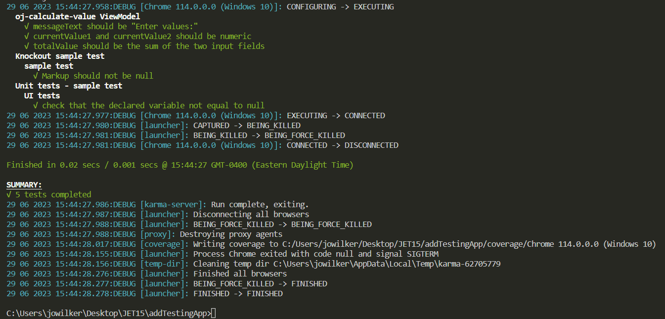

Run the tests. Enter the script
npm run testin the command line and observe the results in the terminal window.
Note the
coveragedirectory that was created in the root directory of your app, after running the tests. It contains theoj-calculate-value-viewModel.js.htmlfile, which you can open in your browser to view more information about the test run.
