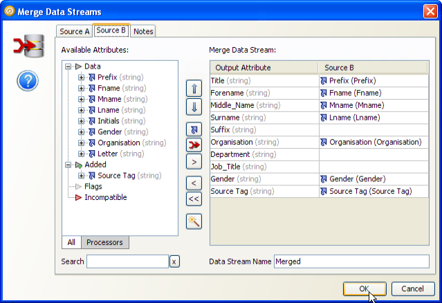

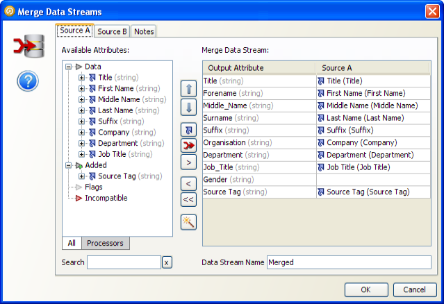

Example
In this example, a number of sources of records representing business contacts are merged into a single data stream.
Merge Data Streams Configuration
