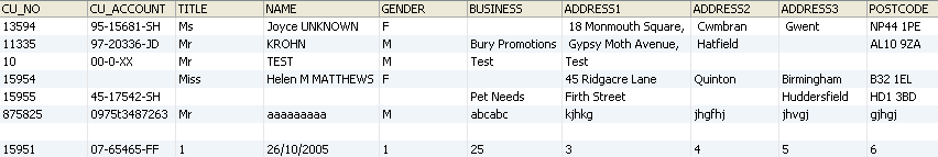

Example
In this example, a number of invalid records are written to a Staged Data table called Quarantine output:
